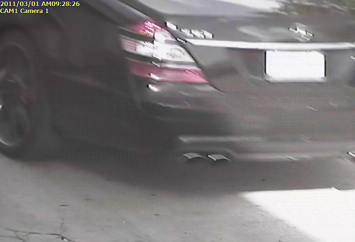

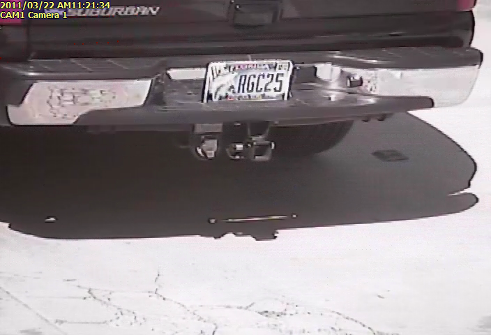

    Please see the below images showing the difference between a normal CCTV Camera (non LPR) and a LPR CCTV camera. NOTE: The cars in the images below were traveling roughly 20-25MPH.
    Notice the image from the camera without the LPR technology is blurred and the plate is whited out from the glare of the sun.
    Next, look below at the image captured by a surveillance camera with license plate recognition technology. The license plate is clearly readable.
