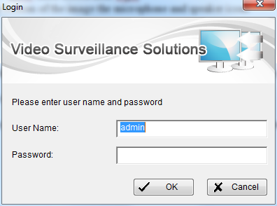

      USING THE NATIVE CAM GRABBA SOFTWARE
    1. Load the Cam Grabba software.
    2. The default user is “admin”
    3. The password should have been set during the installation.

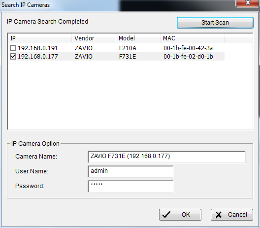

    5. On the top menu select camera → search
    6. Assuming your camera is connected correctly, select it from the search box (be sure to put in the user name and password, both should be “admin” by default.)
    7. Select ok two times.
    8. Your image should come up, right click in the image and select “enable talk”.
    9. 2 way audio should now be working.
