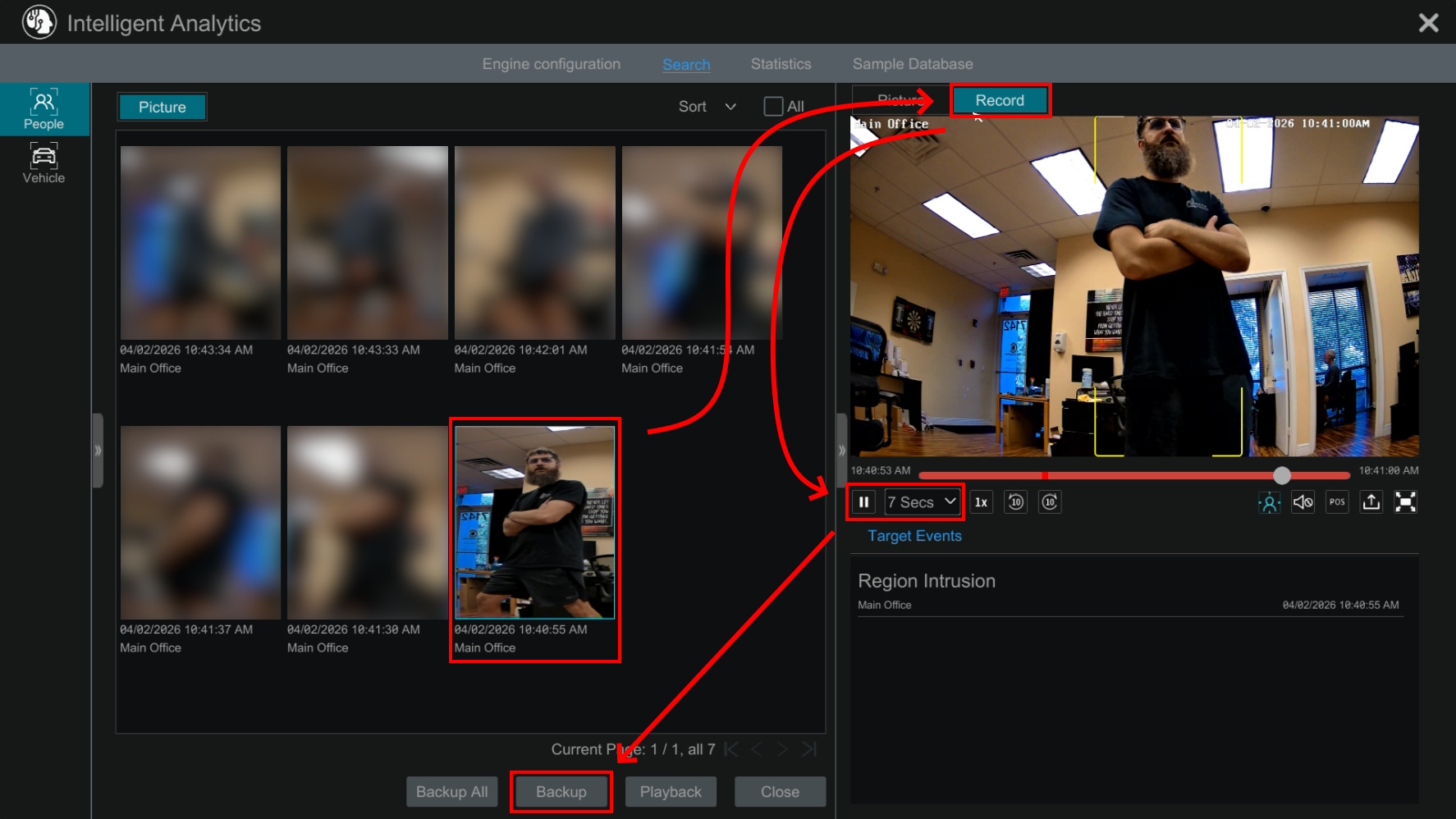

    First, get the Snapshot & Recording of the event.
    This can be found by going to Start -> Intelligent Analytics.
    Then, you can search for your desired event by event type (1), date/time (2), and camera (3). Then, click Search.
    Step-by-step searching for AI Event in Intelligent Analytics
    When you find the false positive event, click it and then select the check-mark box on the top-right of the thumbnail.
    Then switch the viewport to Record. If you would like to, you can Adjust the duration of the recording.
    Step-by-step event selection and export
    Now, insert a USB drive into the NVR.
    Then, click the Backup button and then select Backup Picture and Record.
    Export the data to a place of your choosing on the thumb drive.

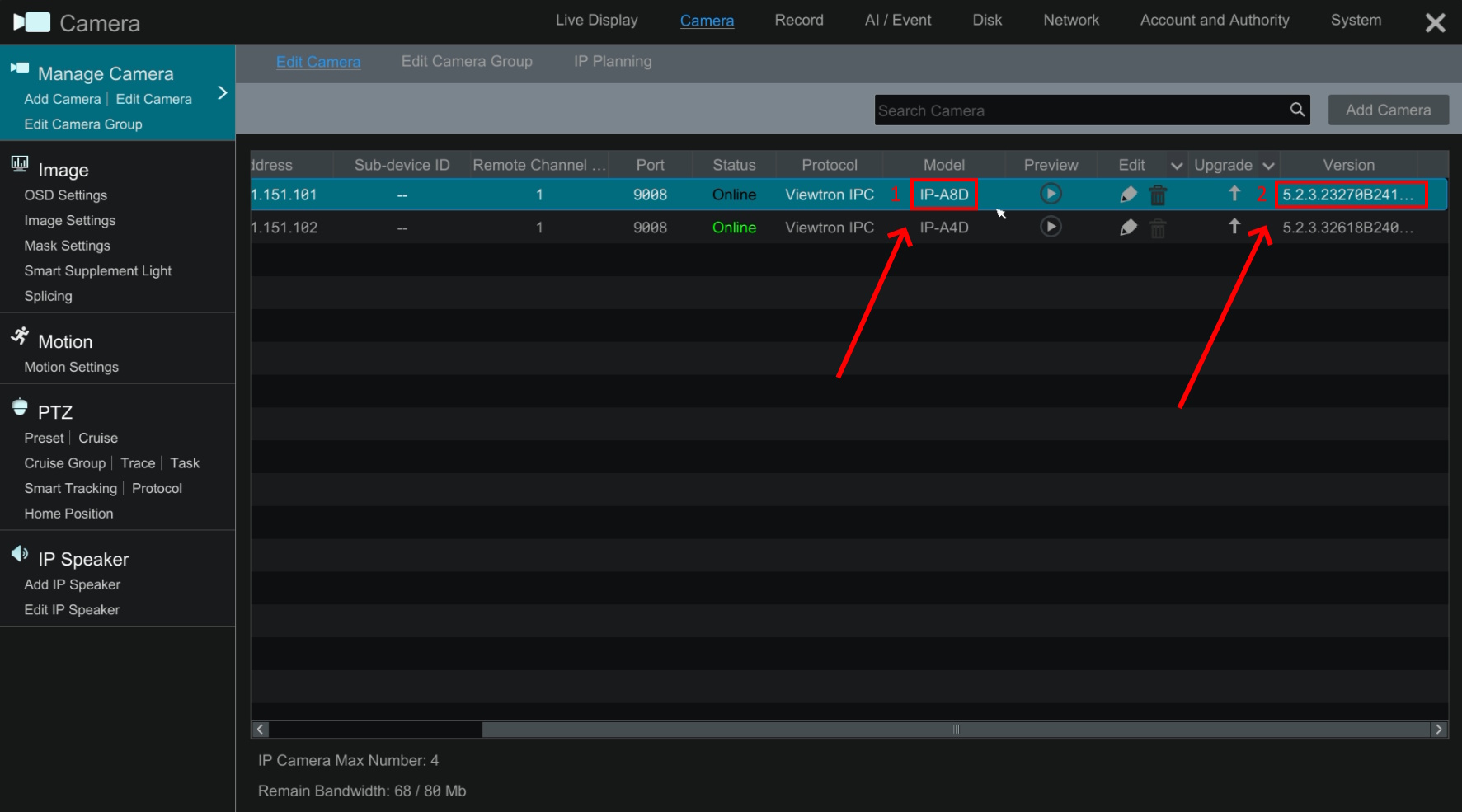

    Finally, find the Model and Firmware Version of the camera that captured the false positive.
    The Model (1) and Firmware Version (2) of your camera can be found by going to:
    Start -> Settings -> Camera -> Edit Camera
    You may need to scroll to the right on the bottom scroll bar.
    Here is where to find the Model and Firmware for your camera
