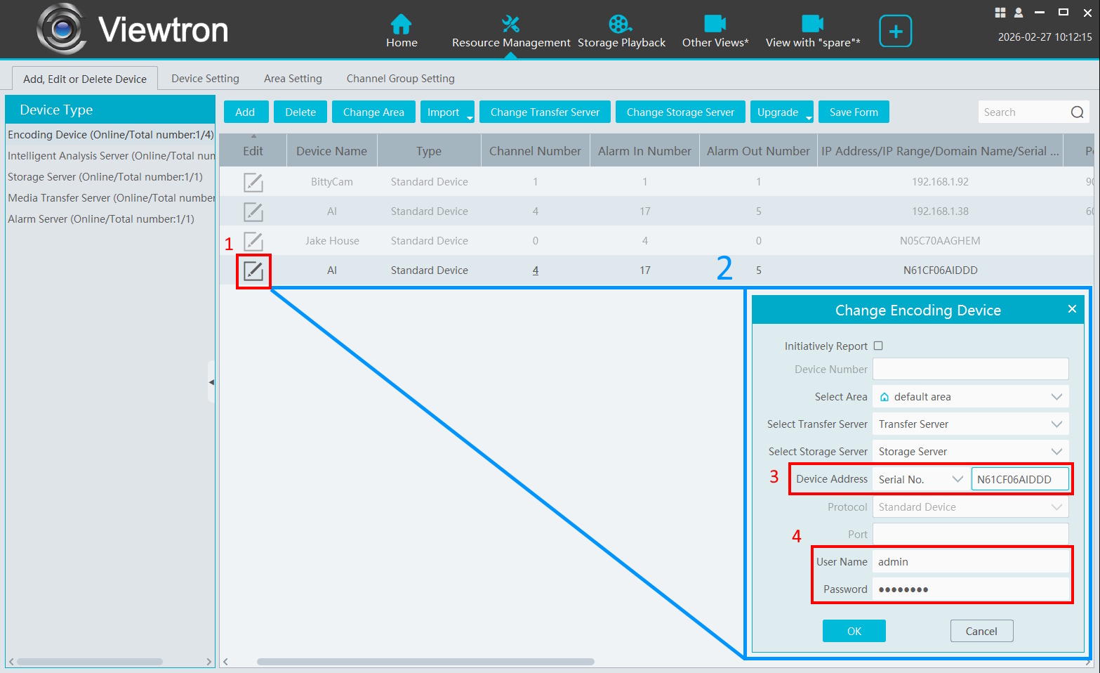

    Step 2: Double-Check your credentials
    Make sure that you have entered your credentials correctly. In the Resource Management tab of the VMS Software, Edit (1) your device settings and make sure that the Serial Number (3) and User/password (4) are correct.

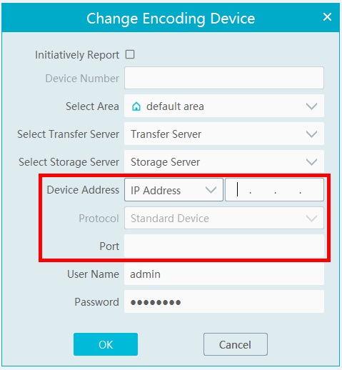

    In the case that you are using a Static IP Address instead of a Serial Number, double-check to make sure that it matches the serial number of the device you are connecting to. (Please note that we do not recommend this method; if you encounter a system reboot of your devices while they are set to DHCP, its IP can change)

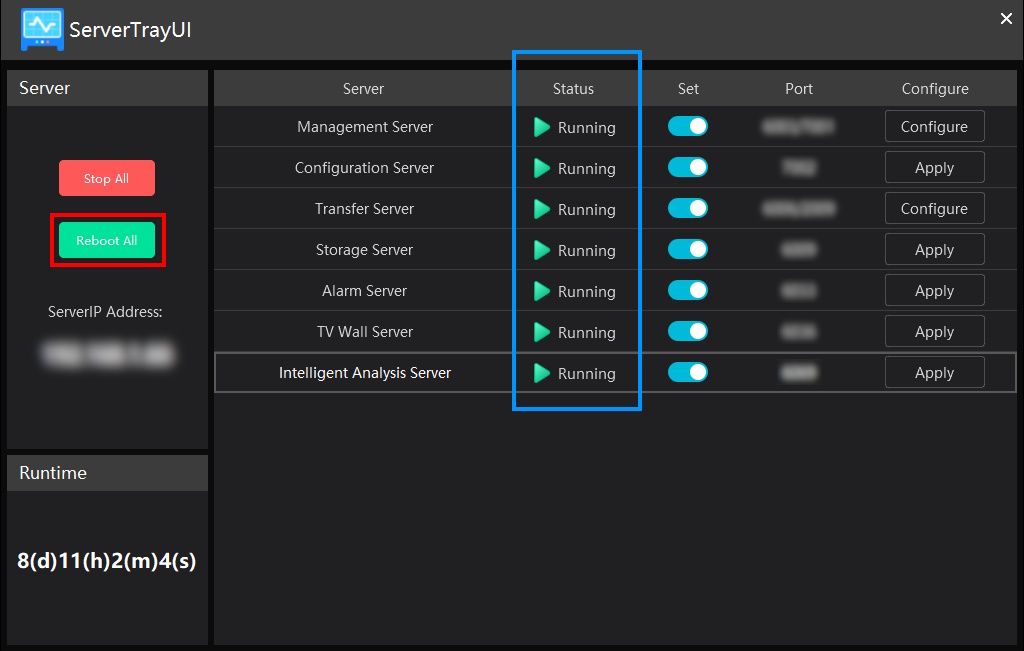

    Step 3: Reboot Services using ServerTrayUI
    Sometimes, there can be a hang-up within the local service that manages the VMS software on your pc. This can prevent your PC from connecting to other devices. Here’s how to reboot the VMS server:
    First, search for “ServerTrayUI” on your computer. You can search for it in the Start Menu on Windows, or the Applications Folder for Mac.
    Next, Locate the ServerTray UI icon in the Show Hidden Icons section of your PC. It’s a small arrow on the right side of your screen.
    Once the app opens, check the Status to see if all the servers are running. Even if they are, press the Reboot All button and wait for the status to refresh to Running.
    Then, restart the VMS software.
