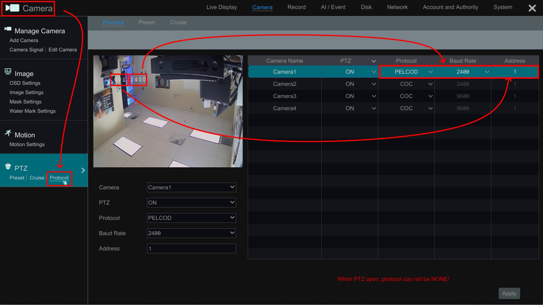

    Once you have connected the RS485 cables to your DVR, you will have to change the Control Protocol, BAUD rate, and Address settings in the Viewtron DVR (These values can typically be found in the OSD menu of your camera).
    Once you find these values, locate the settings in the Protocol menu:
    Start -> Settings – > Camera -> PTZ -> Protocol
    Once you match the Protocol, Baud Rate, and Address and click Apply, you should then be able to go to the PTZ control in the Live Display menu and control your cameras.
