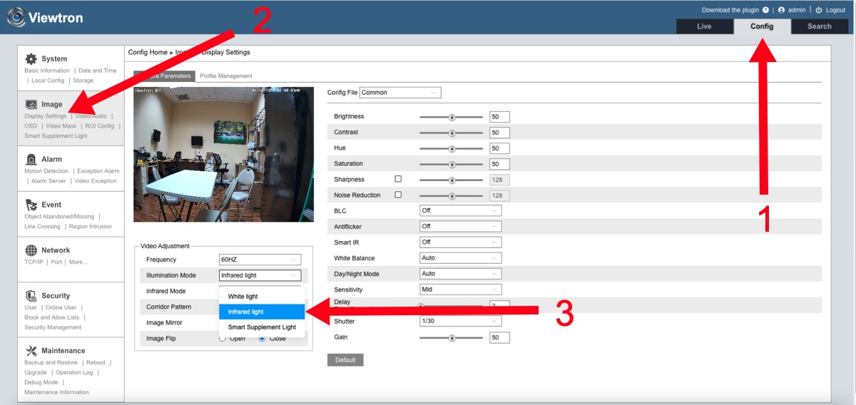

    If your camera is not connected to a Viewtron NVR, log into your IP camera directly from a web browser.
    dual LED camera modes
    Then do the following.
    1. Click on the Config link.
    2. Click on the Display Settings link.
    3. Change the setting on the Infrared Mode dropdown box to Infrared Light.
    Now your dual LED camera will act like a traditional IR night vision camera and it will not use the white spot light LED.
