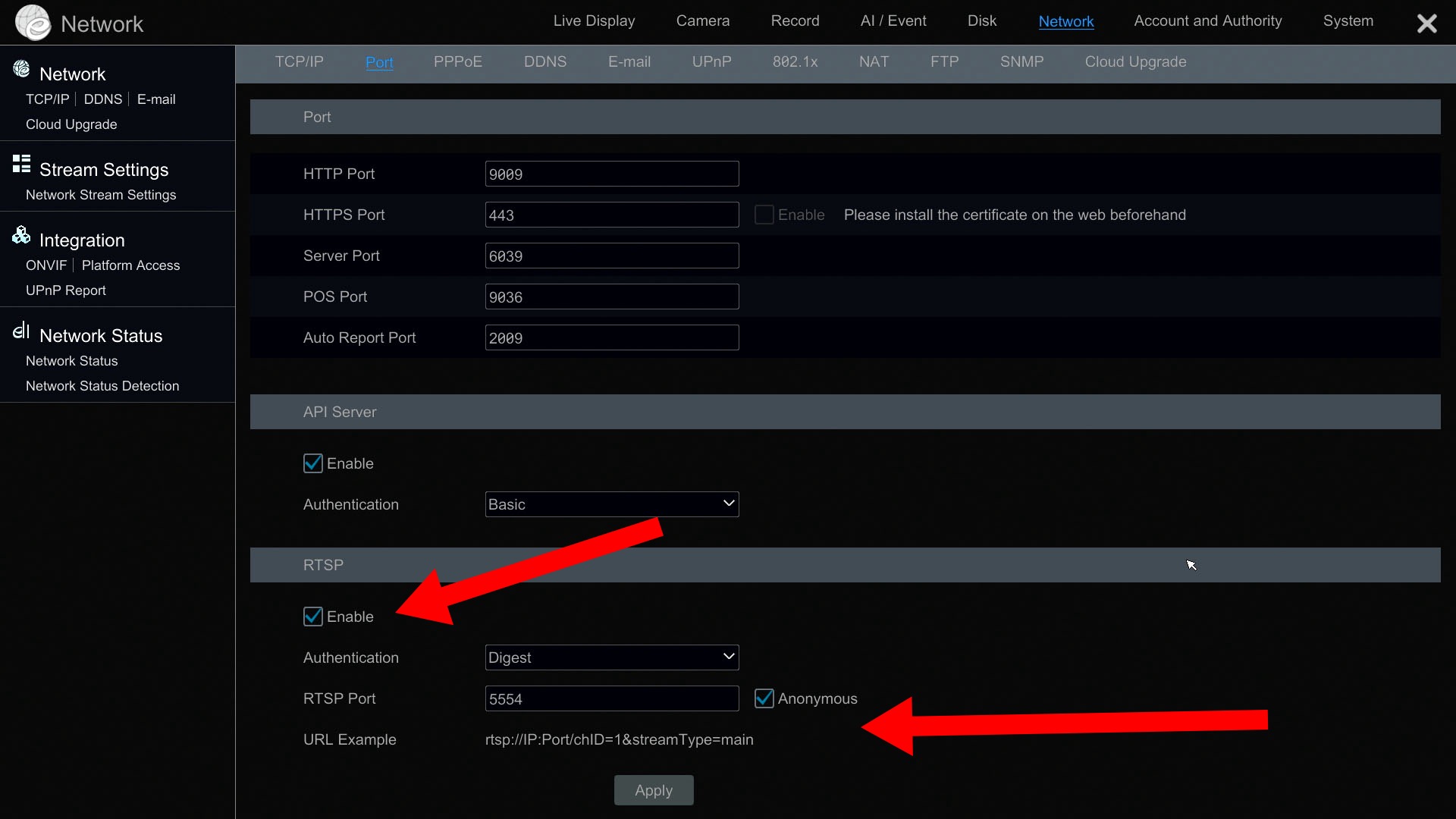

    1. On your Viewtron DVR or NVR, access the Network > Port settings page.
    2. Check the Enable checkbox in the RTSP section.
    3. Check Anonymous if you do not want to password protect the RTSP URL.
    4. Make note of the URL Example.
    5. Click Apply.
    Now you can access the RTSP stream of each camera connected to the DVR using the following URL format
    In the first example, we are accessing the RTSP stream of camera one on using the main stream (highest resolution).
    In the second example, we are accessing the RTSP stream of camera two using the sub stream (lower resolution stream).
    In both cases 192.168.0.101 is the local IP address of the Viewtron DVR.
