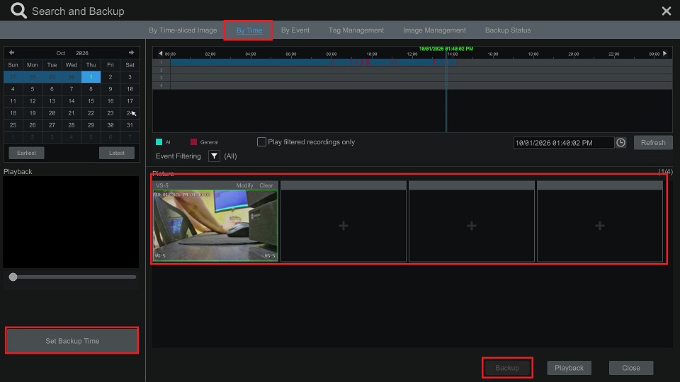

    2. Set the backup time and cameras
    1. Open the By Time tab at the top.
    2. Click Set Backup Time and enter the Start and End times.
    3. Click the + button in the blank Picture slots on the right and select the cameras you want to export.
    4. Click Backup.
    Viewtron Search and Backup By Time tab with Set Backup Time, camera slots, and Backup highlighted

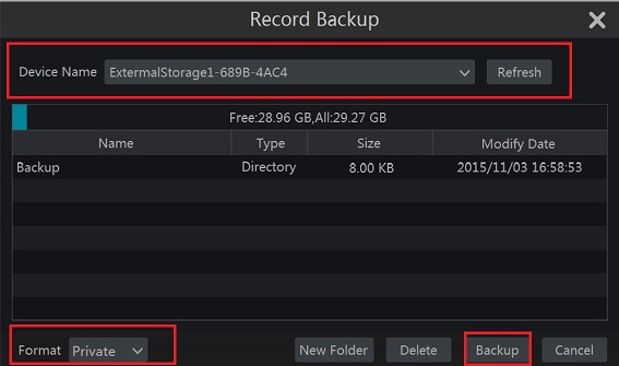

    3. Save to USB as AVI or MP4
    When the Record Backup window opens:
    1. Select your USB storage device under Device Name.
    2. Set Format to AVI or MP4 (do not leave it on Private if you want to play the file on a computer).
    3. Click Backup.
    Viewtron Record Backup window with Device Name, Format, and Backup highlighted

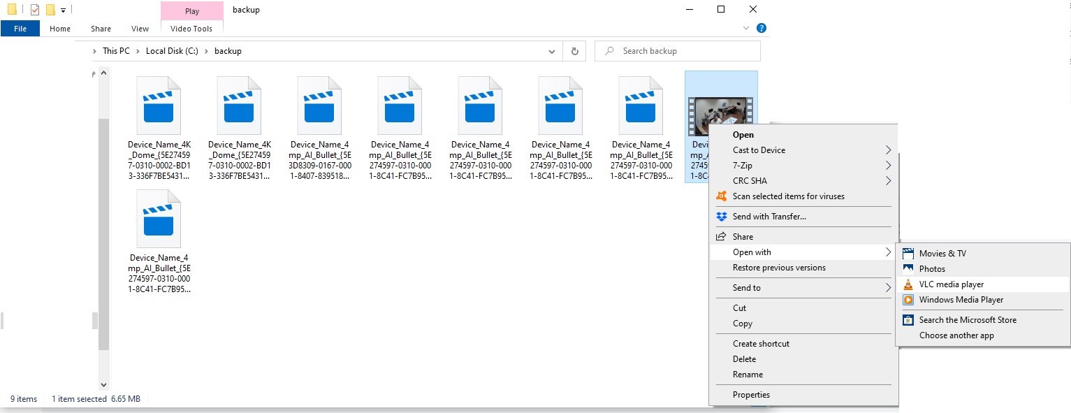

    4. Play the exported video in VLC
    Plug the USB thumb drive into a computer with VLC media player installed (free download). Right-click the exported video file, choose Open with, then VLC media player.
    Windows Explorer Open with menu selecting VLC media player for an exported Viewtron backup video
