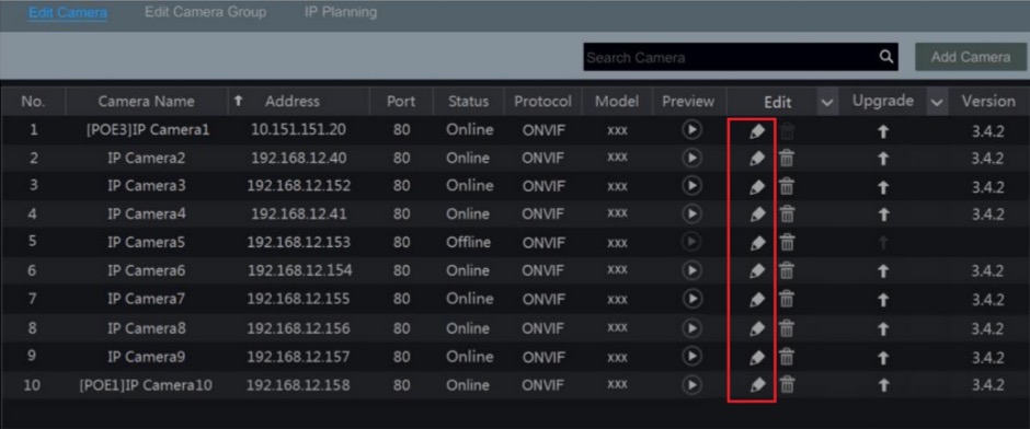

    If the NVR does not connect to the camera, add the ONVIF user to the NVR.
    On the Viewtron NVR go to START > SETTINGS > EDIT CAMERA > Click the EDIT button next to the camera and enter in the ONVIF username and password you created.
    NVR ONVIF IP Camera Settings
