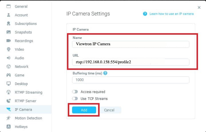

    3. Select the ADD IP CAMERA option > Type in a name for the camera and the cameras RTSP callout
    IP camera Zoom RTSP setup
