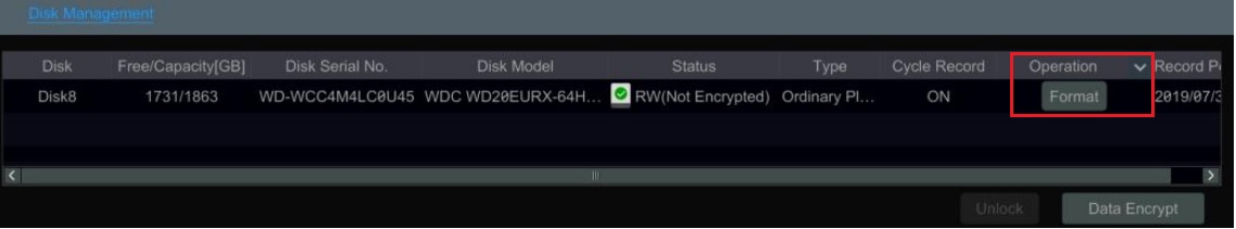

    3. Format the new drive in Disk Management
    Put the top cover back on, power the recorder on, then:
    1. Go to Start > Settings > Disk Management.
    2. Find the new HDD in the list.
    3. Click the Format button next to that drive.
    Viewtron Disk Management screen with the Format button highlighted for a new hard drive
    After formatting finishes, the new storage HDD will be added as a storage device and the NVR / DVR will record to it.
