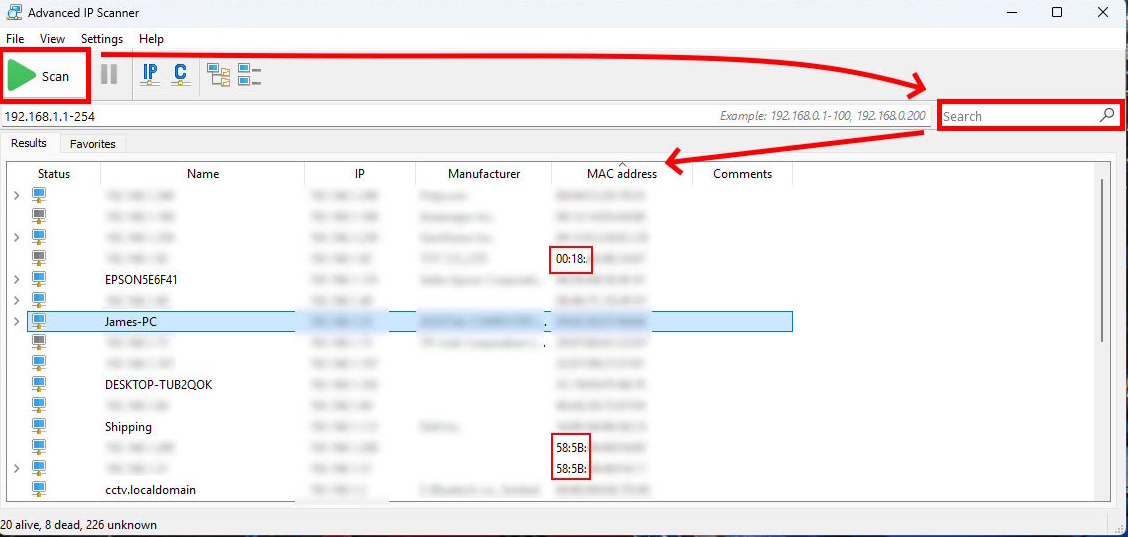

    2. Using Advanced IP Scanner
    1. Download and install Advanced IP Scanner from the publisher’s site, then run a scan of your local subnet (for example 192.168.1.1-254).
    2. Look for your Viewtron camera by searching “58:5B” in the search bar, and note the IP addresses shown
    3. Open a browser and log in to the camera WebUI by using its’ IP address.
    Advanced IP Scanner finds devices on the network; it does not replace the Viewtron IP Tool for applying Viewtron-specific network changes.

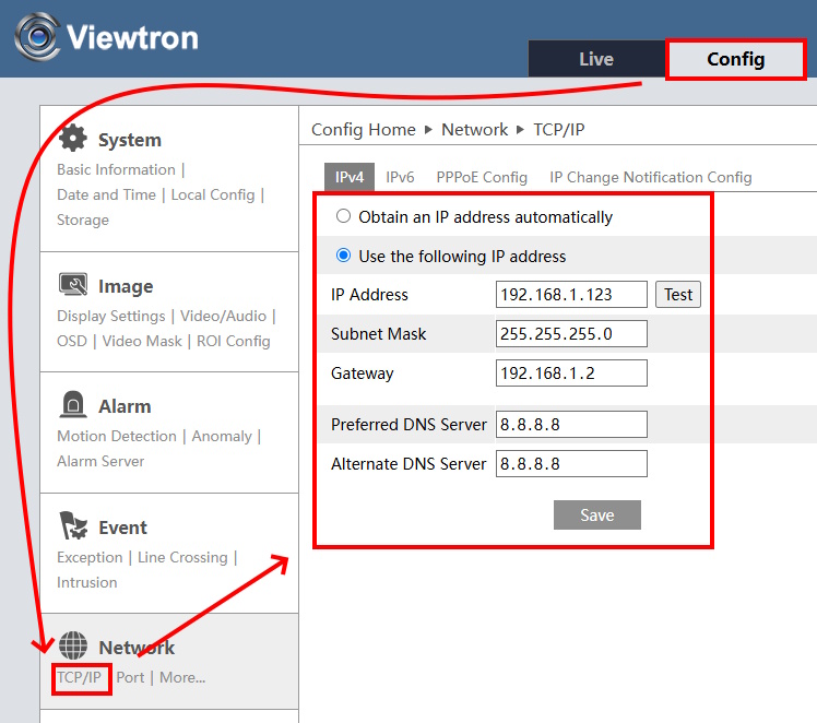

    Once you know the camera IP and can reach it in a browser:
    1. Open the Config tab and select Network -> TCP/IP
    2. Choose a static IP and enter the IP address, subnet mask, and gateway that match your LAN, or choose to obtain an IP address automatically (DHCP).
    3. Save/apply the settings. The camera may reboot or drop the browser session; reconnect using the new IP if you set a static address.
