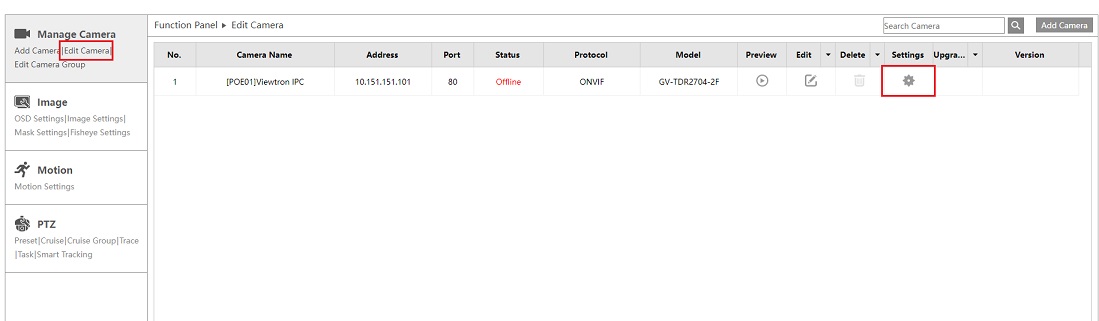

    2. Open the camera web UI from Edit Camera
    Once you are logged into the NVR web UI:
    1. Go to Function Panel > Camera > Edit Camera.
    2. Find the camera in the list.
    3. Click the Settings (gear) icon for that camera.
    The NVR opens that camera’s direct web UI so you can change camera settings while it stays connected to the NVR PoE port.
    Viewtron NVR Edit Camera page with Edit Camera menu and Settings gear highlighted
