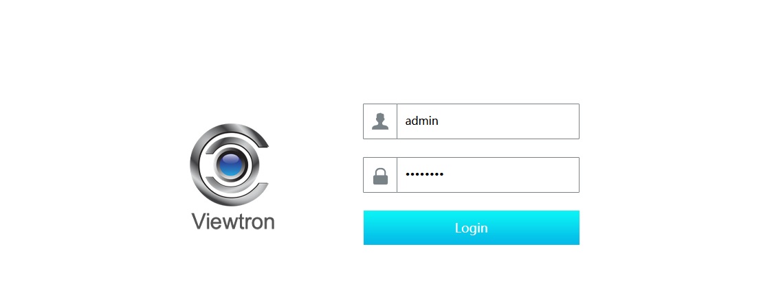

    2. Log into the DVR / NVR web UI
    When the login screen appears, sign in with the recorder username and password. The factory default is username admin and password a1111111 (change it if you already set a custom password).
    Viewtron DVR or NVR web UI login screen

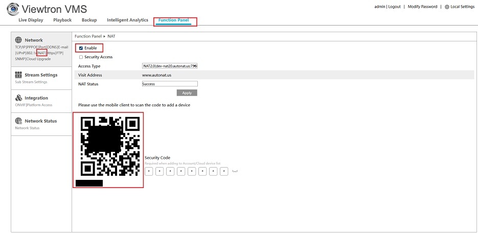

    3. Open NAT and scan the QR code
    Once you are logged in:
    1. Go to Settings (Function Panel) > Network > NAT.
    2. Open the SuperLive Plus app on your phone.
    3. Scan the QR code shown on the NAT page. The app prefills the DVR / NVR connection details; type the recorder password in manually.
    Viewtron DVR or NVR web UI NAT page showing SuperLive Plus QR code

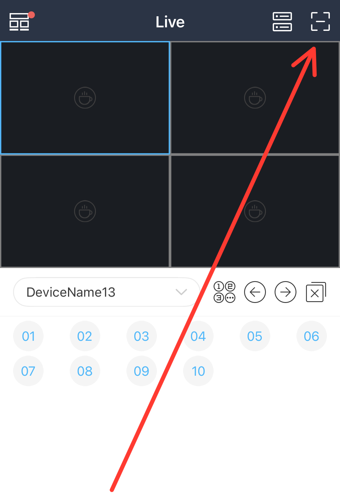

    5. Scan the QR code from the Live screen
    In SuperLive Plus:
    1. Open the app to the Live screen.
    2. Tap the QR Scan icon in the top right of the app UI.
    3. Scan the QR code from the recorder NAT page.
    SuperLive Plus Live screen with QR Scan icon highlighted

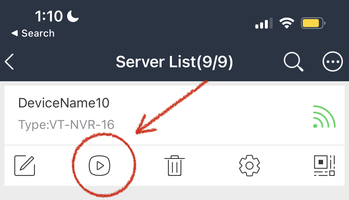

    6. Play live video when the connection is green
    After the device is added, you should see a green Wi-Fi signal next to the new connection. When it is green, tap the Play button to view the live security camera video feed.
    SuperLive Plus connection list with green Wi-Fi signal and Play button
