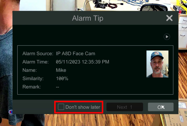

    If you enable the Pop-up Message trigger in the Trigger General section, you should get a pop-up notification on the Live View screen, like this:
    However, if you press “Don’t show later” on that pop-up box, the pop-ups will be disabled regardless of your trigger settings.

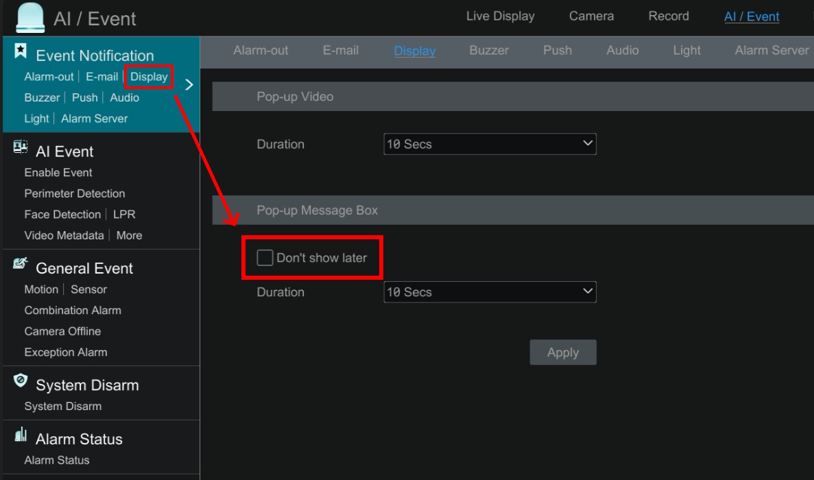

    Once that pop-up disappears, you will need to go into your settings to re-enable pop-ups. Here’s where you do that:
    Settings  ->  AI/Event  ->  Event Notification  ->  Display
    Once you go here, you will find yourself on this screen where you can disable the check-box.
    Your pop-ups will now appear again!
