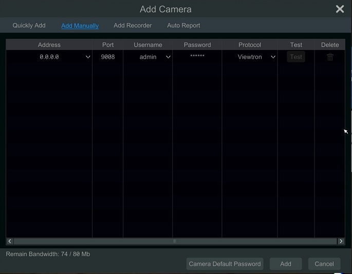

    3. Manually add the camera on the Viewtron NVR (ONVIF)
    Once ONVIF is enabled on the Reolink, add it by IP on the Viewtron NVR.
    Path:
    START > SETTINGS (or FUNCTION PANEL from the web UI) > ADD CAMERA under CAMERA > MANUALLY ADD tab.
    Fill in:
    • ADDRESS — camera IP address on your LAN
    • PORT — 80
    • USERNAME — camera username
    • PASSWORD — camera password
    • PROTOCOL — ONVIF
    Then Add / Apply and confirm the channel comes up on live view and recording.
    Viewtron NVR manually add Reolink camera via ONVIF port 80
