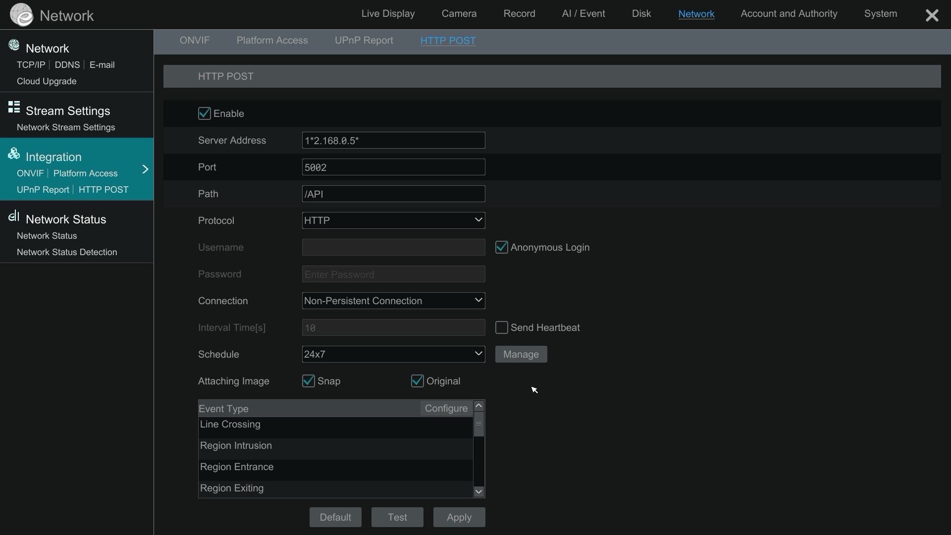

    1. Click on the HTTP POST link on the left menu under Integration.
    2. On the HTTP POST screen, check the enable checkbox.
    3. Enter the server connection information that you want the HTTP POST webhook to be sent to.
    4. Check the Snap and Original image check boxes if you want to send JPEG images of the event to your server.
    5. Click on the Apply button.

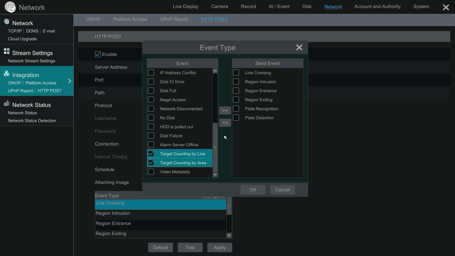

    6. Next to Event Type. Click on the Configure button.
    IP Camera API enable events on NVR
    On the Event Type screen
    1. Select which events types that you included in your application on the left side of the screen
    2. Click on the >> button to move those events to the Send Event side of the screen.
    3. Click OK after you have added all of the event types that you want to include.
    4. When you return to the main HTTP POST screen, click Apply again.
    If your server is ready to receieve POSTs, you can click on the Test button to test the connection between the Viewtron NVR and you API server application.
