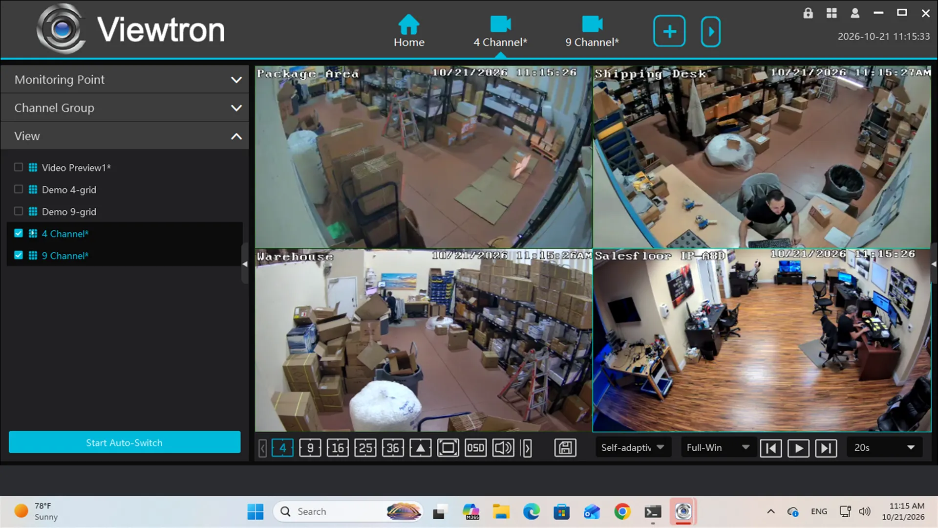

    1. Open Video Preview and expand the View list in the left panel.
    2. Tick the box next to each view you want in the sequence (for example, a 4 camera view and a 9 camera view).
    3. Choose the interval in the dropdown at the bottom right (for example, 20s). Options are 5s, 20s, 30s, 1 minute, 3 minute, 5 minute, or Custom time.
    4. Click Start Auto-Switch at the bottom of the left panel. The middle toolbar button shows two pause bars, and the ticked views start taking turns.
    Viewtron VMS for Windows View list with two views ticked and the Start Auto-Switch button

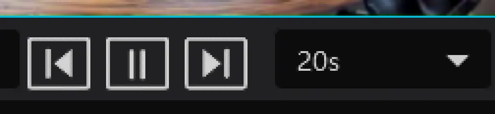

    On Windows the left label always reads Start Auto-Switch, even while the sequence runs. The pause button (two bars) is on the bottom-right toolbar, between the previous group and next group buttons, just left of the interval dropdown.
    To freeze the rotation on Windows, click the pause button. Click it again (or click Start Auto-Switch) to resume.

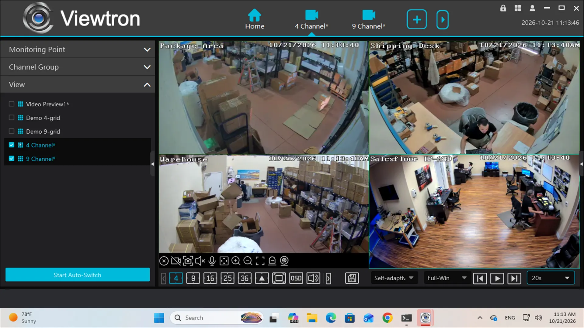

    When paused, the two bars change to a play triangle and the current view stays on screen. The sequence is still on while paused.
    Viewtron VMS for Windows toolbar close-up showing the pause button while Auto-Switch is running
    Viewtron VMS for Windows Video Preview with Auto-Switch paused, play triangle showing
