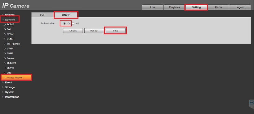

    1. Log into your Dahua cameras Web UI and navigate to NETWORK > SETTING > NETWORK > ACCESS PLATFORM (see below image)
    2. You will need to check the ENABLE ONVIF checkbox > select SAVE.

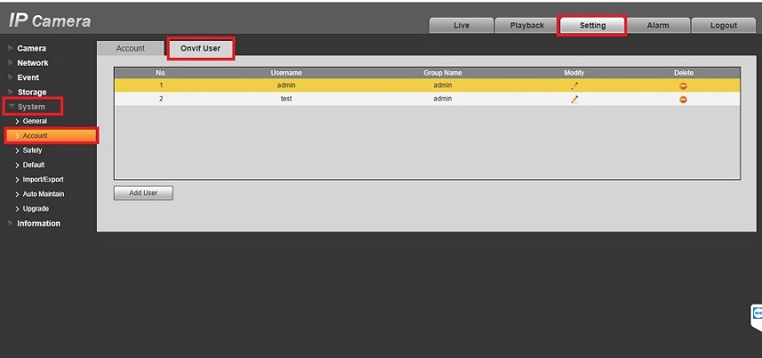

    3. Now navigate to SETTING > SYSTEM > ACCOUNT > ONVIF USER > create an ONVIF user account (username and password) by selecting the ADD USER option.

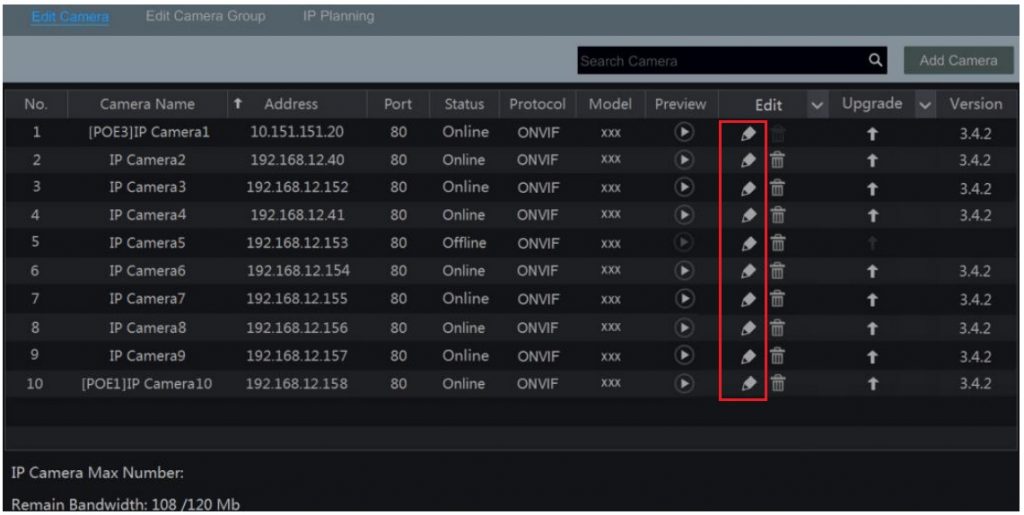

    4. Once you have ONVIF enabled + an ONVIF user account setup, plug the camera into the Viewtron NVR and on the Viewtron the NVR go
    NOTE: If the camera does not connect on the NVR go to START > SETTINGS > EDIT CAMERA > Click the EDIT button next to the camera and enter in the ONVIF username and password you created.
