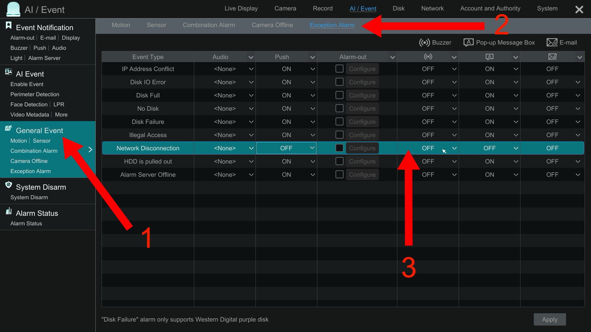

  • By default, Viewtron DVRs and NVRs sound an audible alarm anytime the network connection is interrupted. You can disable your DVR from beeping if your network or Internet connection is interrupted by following these steps.

    1. Click on the General Event link on the left.
    2. Click on the Exception Alarm link on the top navigation.
    3. Setup the Buzzer to Off for the Network Disconnection settings.
    4. Click Apply.
