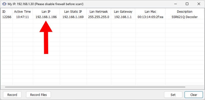

    2. Download the Viewtron Decoder Network Scan Tool on a Windows PC so that you can locate the decoder on your network.
    3. Unzip the file on your PC and run the tool. In Windows 11, this is done by right-clicking and using Extract All. The network scanner will automatically search the network for all Viewtron Encoders & Decoders.
    4. Double-click the Lan IP of the Encoder to log into it through the webpage. The default username is admin and the default password is admin.

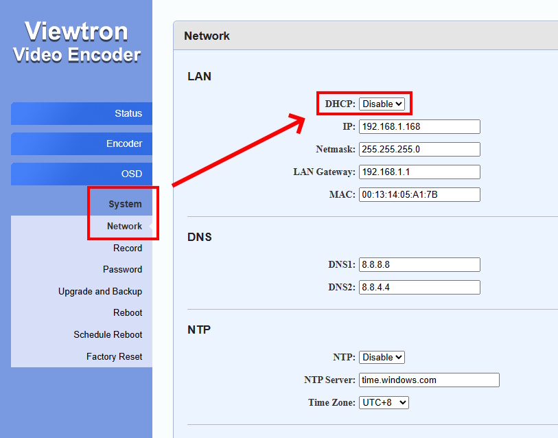

    5. Once on the WebUI, go to System -> Network and disable DHCP. Then, scroll down and click Apply.
    6. The Encoder will prompt you to restart it. Unplug the Encoder from the network and from power.
