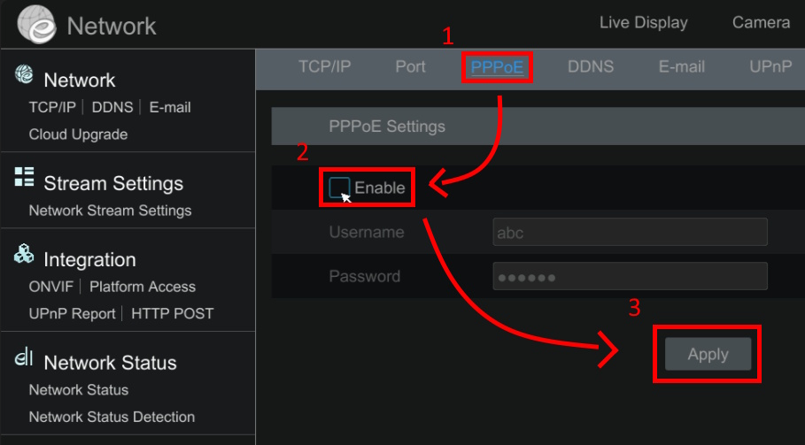

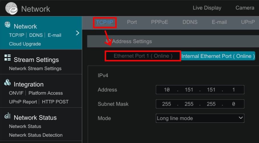

  • If youre configuring a Viewtron NVR or Hybrid DVR for remote access or custom network settings and can’t select the correct Ethernet interface (Ethernet Port 1), there’s a simple setting that may be causing the issue:

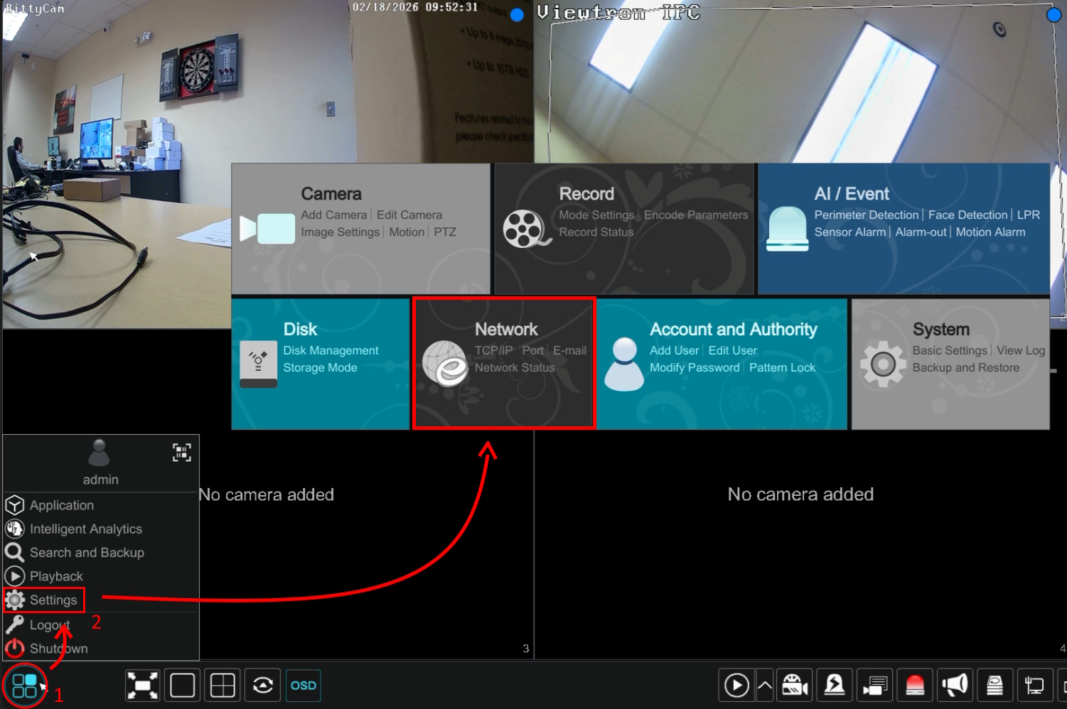

    First, go to the Network page.
    Once in the Network menu, go to PPPoE.
    Make sure that the check-box is Disabled, and then click Apply.

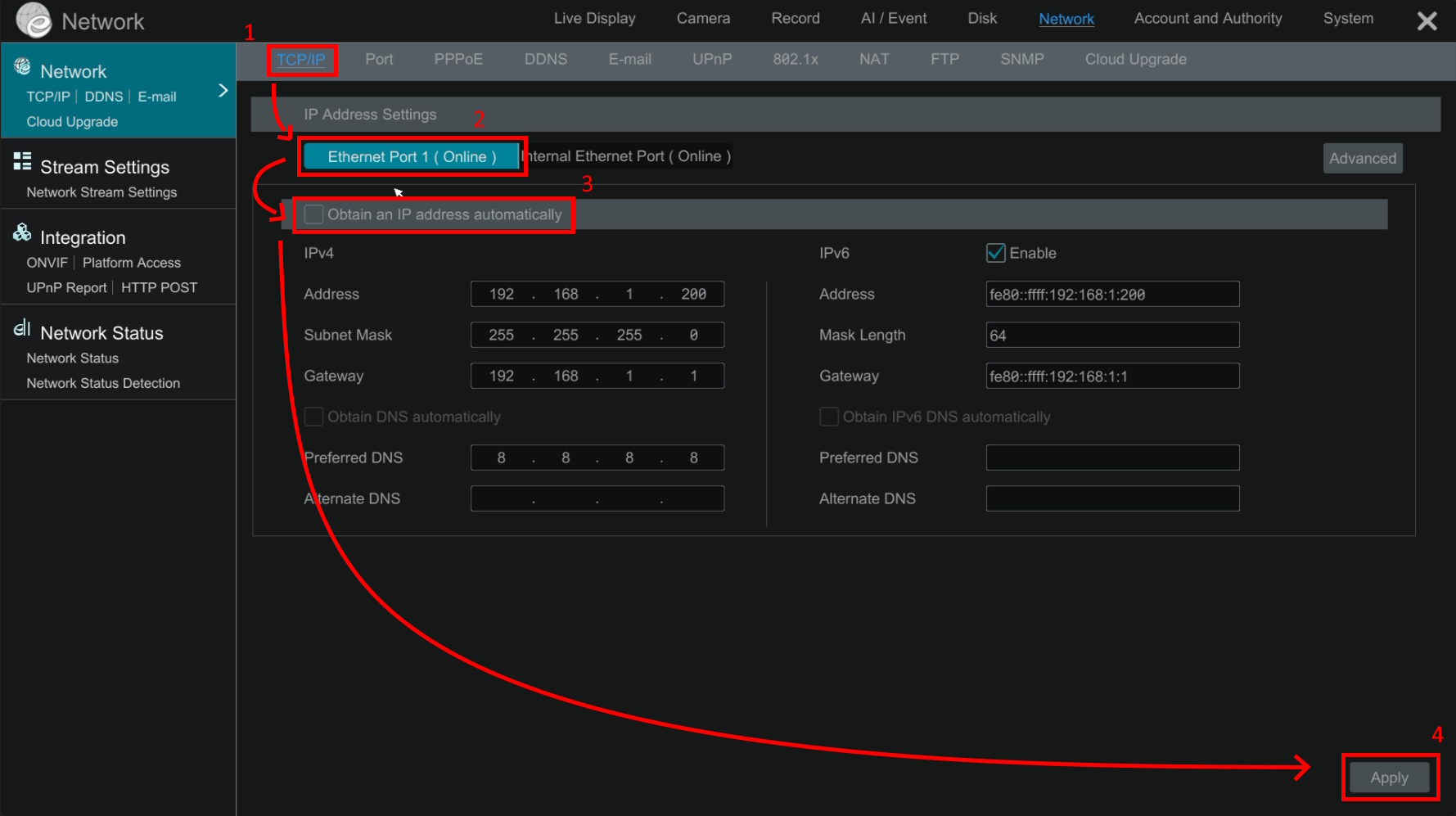

    Now, go back to the TCP/IP page. Enabling and Disabling PPPoE may clear your TCP/IP network settings, so be sure to re-enable Obtain an IP Address Automatically. If you are using a custom network setup you can skip Step 3 on the chart and use your own custom settings.

    If Enabled:
    • The recorder locks certain manual network configuration options.
    • The TCP/IP interface selection becomes restricted.
    • Ethernet Port 1 may be unavailable or greyed out in the TCP/IP menu.
