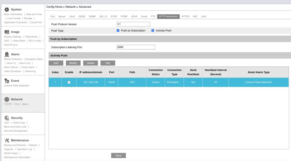

    On the HTTP Post / HTTP Notification screen, click on the Edit button then be sure that V1 is selected in the Push Protocol Version dropdown. Click Save.
    http post API server settings
    Next, click on the Add button.
    IP camera HTTP Post Server
    Then fill in the API server IP address, port, and path. Select Persistent connection from the connection Type dropdown. Set Heartbeat Interval to 30 seconds and check the Send Heartbeat Checkbox. You can also check off the type of alarms and data that you want the server to send. In my testing, I only wanted to send LPR events, so I only checked License Plate Detection in the Smart Alarm Type section. Be sure to check the Smart Alarm Data cehck box. Optionally check the Original and Target picture options if your application will be using the LPR snapshot images. If you are not using images, leave these unchecked as these increase the size of the HTTP Post payload significantly.
    When done, click the Save button.
