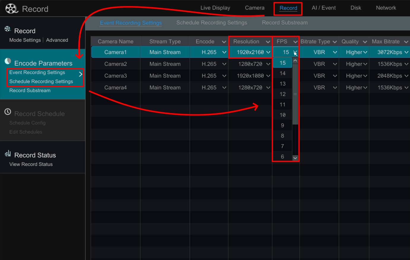

    Then, you can double-check your resolution and framerate in the Encode Parameters:
    Start -> Settings -> Record -> Encode Parameters
    Now you can see there is higher framerates to choose from! The lower resolution will also lengthen your recording time before overwriting.
