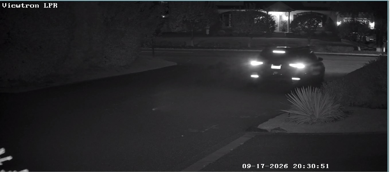

    Night LPR capture showing an overexposed / washed-out license plate

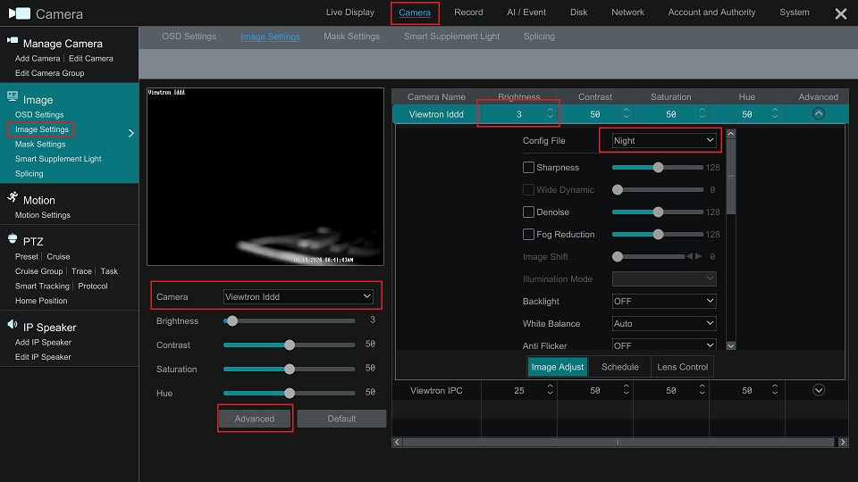

    1. Lower night brightness (Image Settings)
    On the Viewtron NVR:
    1. Go to Start > Settings > Image Settings (under Camera).
    2. Select the LPR camera.
    3. Click Advanced.
    4. Set Config File to Night (use the Night & Day config as shown).
    5. Set Brightness to 3. If it is already 3, try 1 or 2.
    Viewtron NVR Image Settings Advanced night brightness set to 3 for an LPR camera

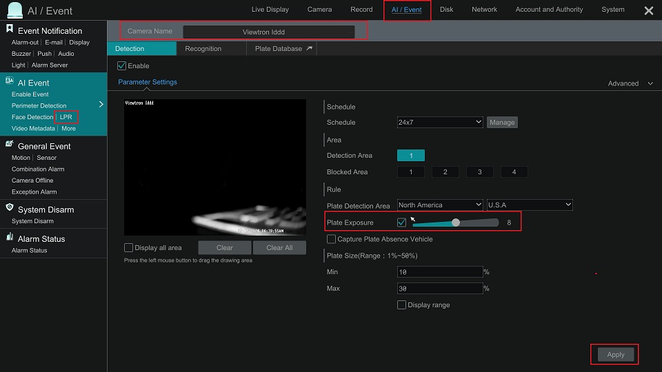

    2. Enable Plate Exposure (LPR settings)
    If night plates are still washed out:
    1. Go to Start > Settings > LPR (under AI / Event).
    2. Check the box next to Plate Exposure.
    3. Set Plate Exposure to 8. If needed, work back toward 6.
    Viewtron NVR LPR settings with Plate Exposure enabled and set to 8

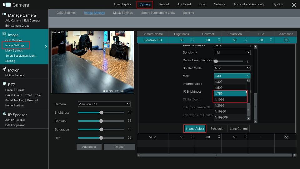

    3. Shorten Max Shutter at night
    Next, tighten the night shutter:
    3. Click Advanced.
    4. Set Config File to Night.
    5. Set Max Shutter to 1/750. If plates are still overexposed, try 1/1000.
    Viewtron NVR Image Settings Advanced night Max Shutter set between 1/750 and 1/1000

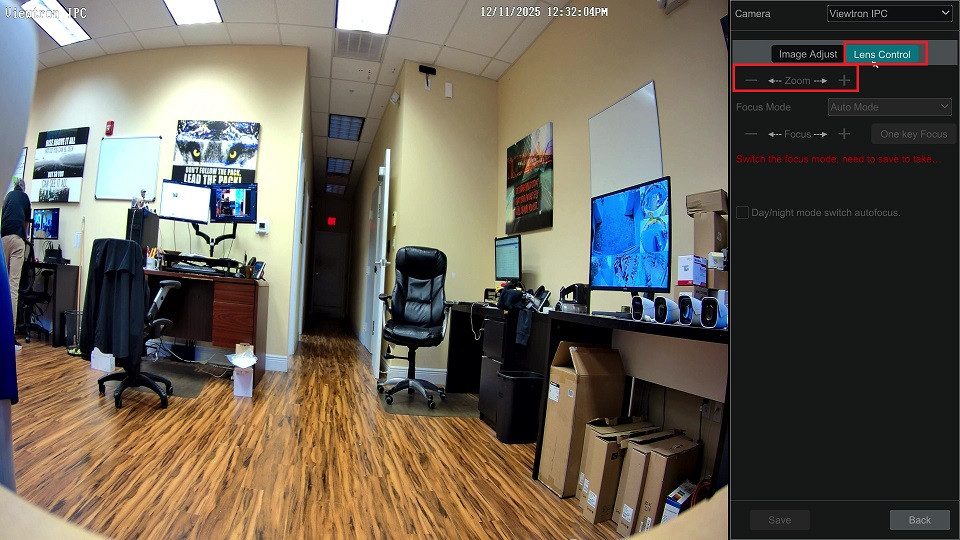

    4. Zoom so the plate fills enough of the frame
    If you are covering a wide area (wider than about two lanes), zoom the camera in. Ideally the license plate should account for at least 6% of the entire video frame.
    From Live View:
    1. Click the LPR camera tile.
    2. Select the Image Adjust icon (it looks like a camera).
    Viewtron NVR live view with Image Adjust camera icon highlighted on an LPR camera
    Then open the Lens Control tab and hold Zoom + to optically zoom in.
    Viewtron NVR Lens Control tab with Zoom plus button for optical zoom on an LPR camera
