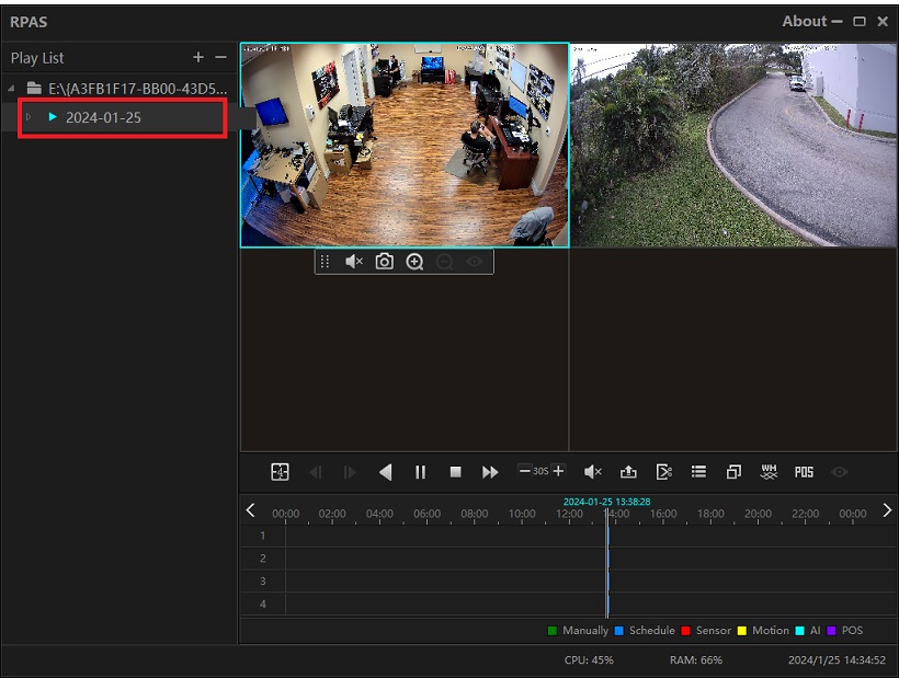

    1. Unzip the download and run RPAS.exe.
    2. Select Open Folder.
    3. Select the folder of your video backup. You should now see the folder name in the upper left corner of the RPAS player.
    4. Expand the folder so you can see the backup date.
    5. Double-click the date and the video will start to play.
    RPAS video player playing a Viewtron DVR NVR Private db3 video backup on a Windows PC

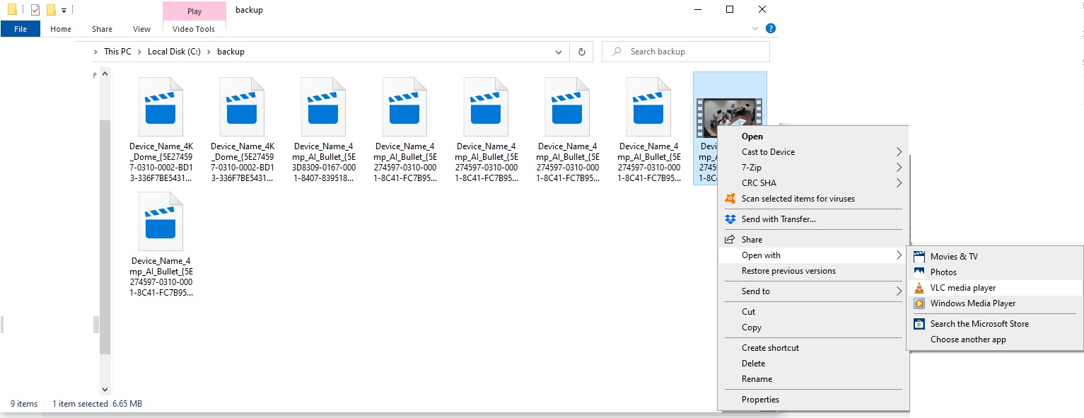

    If you backed up the video as AVI or MP4, we recommend VLC media player. It is free and you can download it here: VLC media player download.
    1. Install VLC media player.
    2. Right-click the video file and select Open with, then VLC media player.
    Opening an AVI video exported from a Viewtron NVR with VLC media player using Open with in Windows
