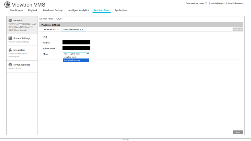

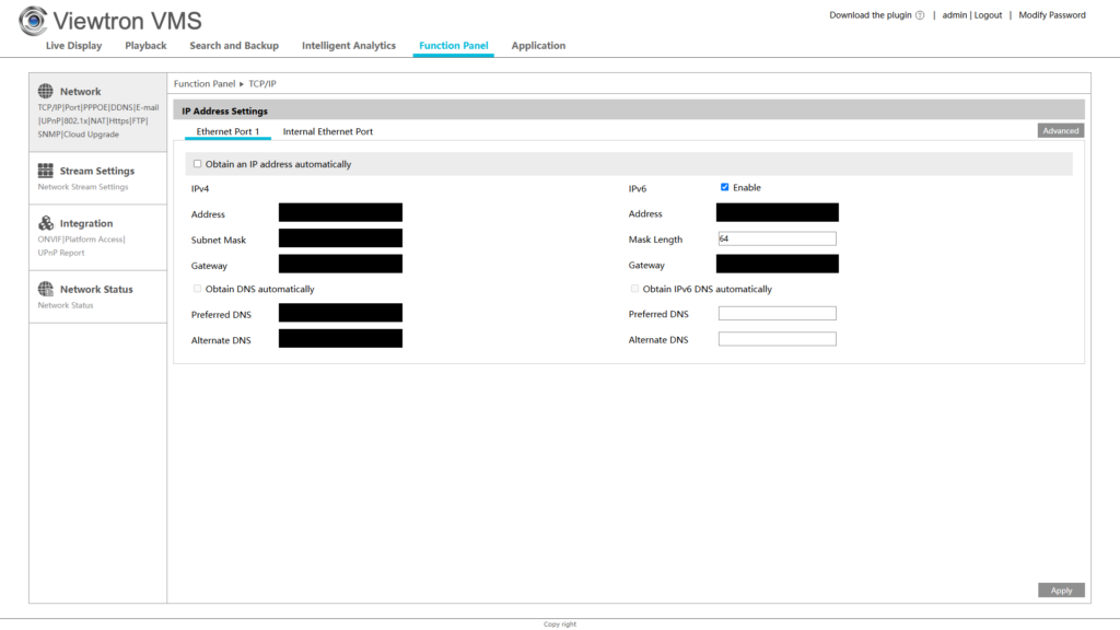

    In the NVR web interface (the local NVR menu looks almost the same), go to Function Panel > Network > TCP/IP, click the Internal Ethernet Port tab, set Mode to Long line mode and click Apply. The NVR manual recommends long line mode when the cables to the PoE ports are very long or not performing well. You can find these settings in section 12.1.1 of the Viewtron NVR user manual (PDF).
    Viewtron NVR web interface Network TCP/IP settings page
    Viewtron NVR Internal Ethernet Port tab with Mode set to Long line mode
