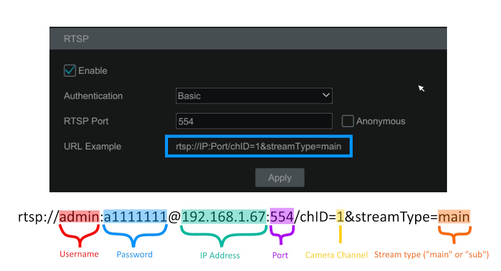

    3. Enable RTSP on your Viewtron Recorder.
         This can be done by going to Start > Settings > Network > Port
         Then, check the Enable box and Apply.
    Note the URL Example. It will be used later.

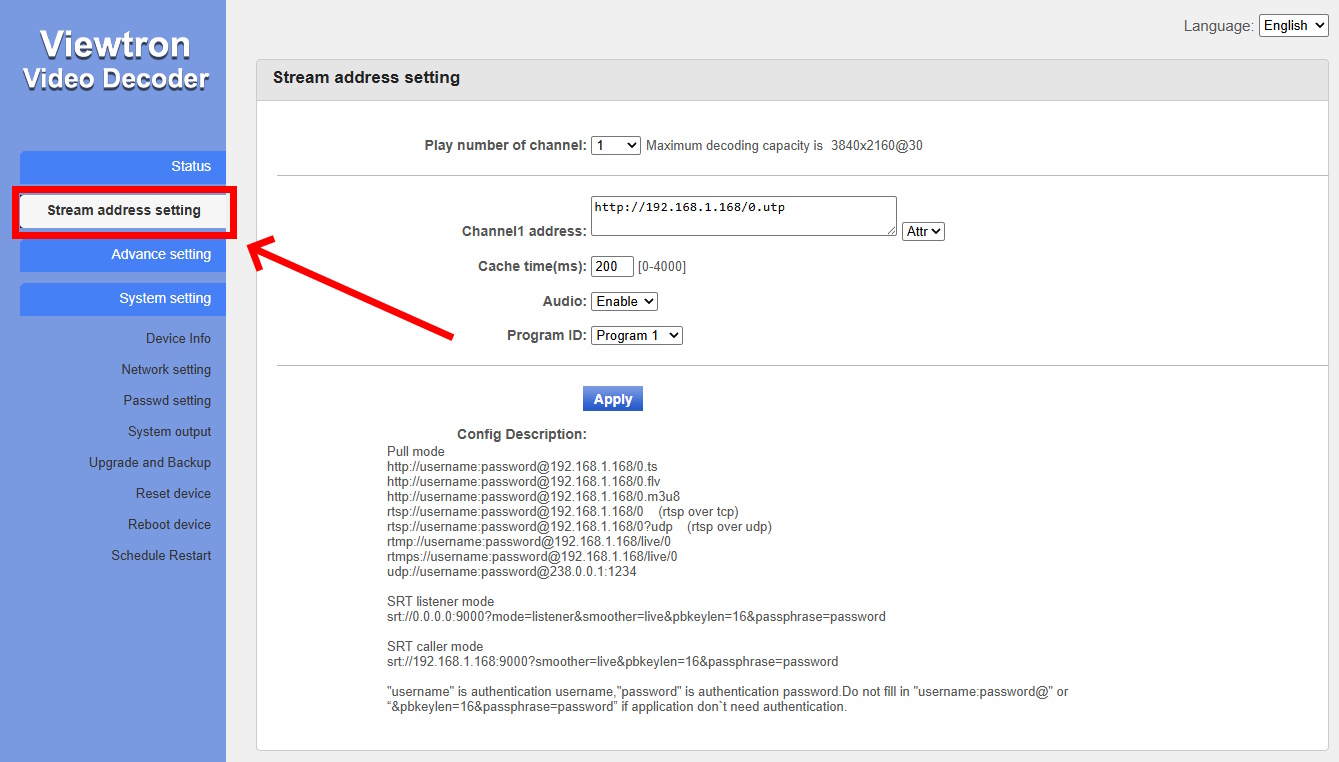

    4. You can double-click the Lan IP of the Decoder to log into it through the webpage.
    5. The default username is admin and the default password is admin. Once you are logged into the decoder, click on the Stream Address Setting tab and stay on that page for now.

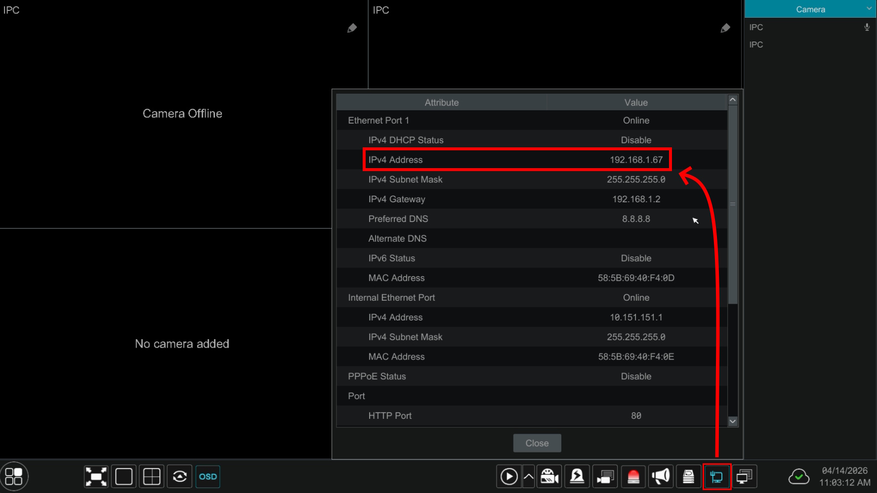

    1. Find your recorder’s IP address. You can find this on the Live Display screen by clicking

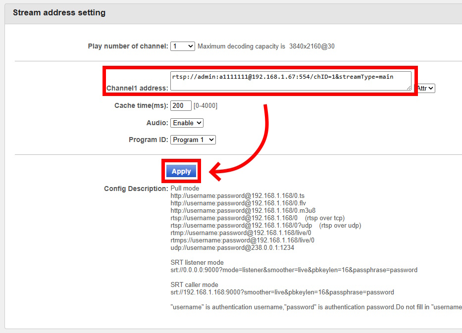

    2. Then, using that information and the URL Example in the Port settings from earlier, we can create our Channel Address(es).
         3. Plug your Channel Address into the Channel(#) address box. Then, hit Apply.
         4. The Decoder will prompt you to restart it. Just unplug it from power, and then plug it back in.
