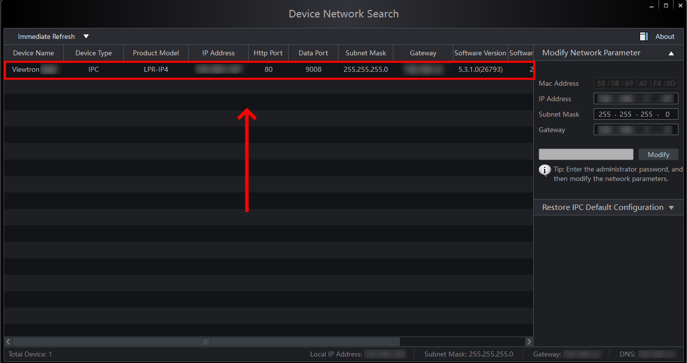

    Now get on a PC connected to the same network as your camera.
    Download the Viewtron IPTool for Windows or Mac. This tool allows you to find Viewtron devices on your network.
    You can double-click the LPR camera to open its’s WebUI.

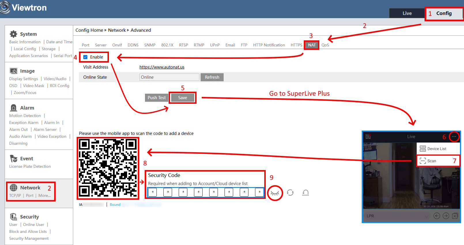

    Once you have logged into the WebUI, follow these steps:
    • Go to Config (1) -> Network (2) -> NAT (3) and then Enable NAT (4). Then Save (5).
    • Now, go to SuperLive Plus and Scan for Devices (6 + 7)
    • You can Scan the QR Code (8) and then enter the Security Code on the last box of the Add Device screen.
    While you are in the WebUI, you can also configure the License Plate Recognition settings in:
    Event -> License Plate Detection

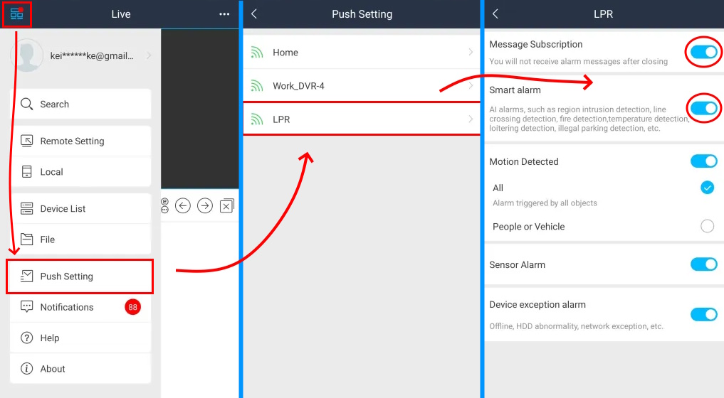

    Configuring Notifications with your LPR
    Now that the LPR is tied to your mobile device, you’ll need to ensure that push notifications are on.
    You can do this by going to Push Settings, selecting your LPR and Enabling Message Subscription and Smart Alarm
    Ensure that your LPR settings are configured properly so you can receive notifications.
