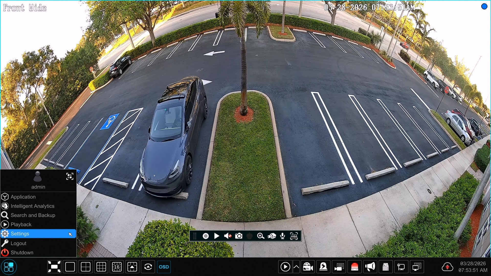

    DVR NVR Settings
    Click on the menu button in the lower left, then select Settings.

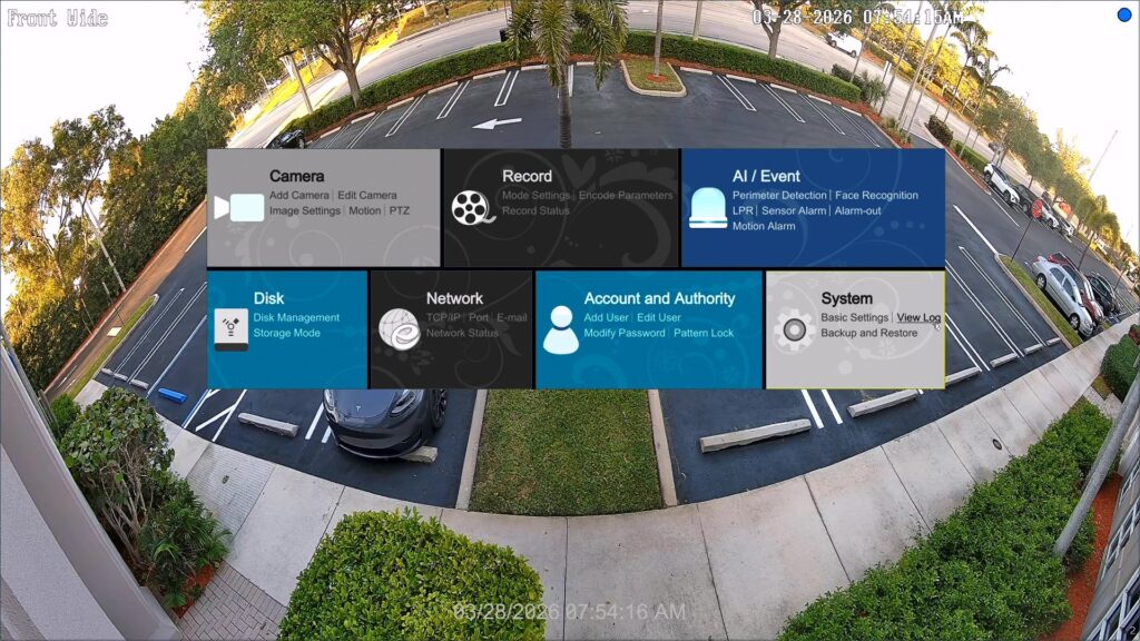

    DVR NVR System View Log
    On the main settings page, click on View Log in the System section.

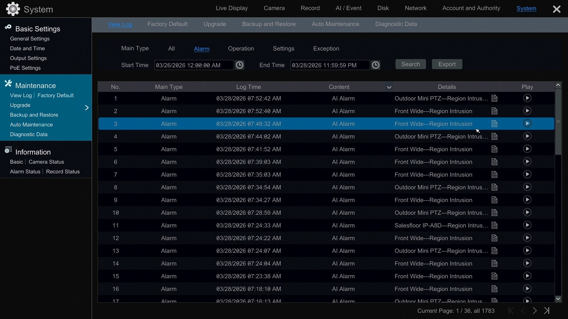

    DVR NVR System Log Screen

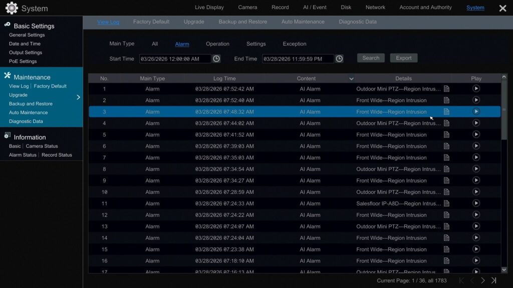

    On the System View Log screen, you can choose a date range for the event you are searching for. You can also select the type of event you want displayed if you want to narrow down your search.
    For event types where there was a video recording, you can click on the video player icon next to the event to playback the recorded video surveillance footage.
