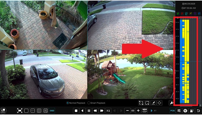

    2. Confirm recording on the playback timeline
    Open PLAYBACK. The time bar uses the same color language. Dark blue / blue blocks usually mean recorded video with no special event; yellow and other event colors mark motion or alarm segments you can jump to.
    Viewtron playback menu timeline with blue continuous and yellow motion recording colors
    If the timeline is empty for a channel and hour you expected to cover, that channel was not recording then — check hard-drive status, channel enable, and the recording schedule next.
