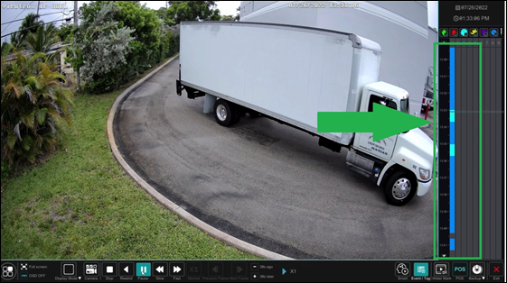

    3. Find Audio Exception events in playback
    After setup, review recordings the usual way. Video playback overview: Viewtron DVR / NVR playback.
    On the playback timeline, Audio Exception (and other AI / event flags) show as a turquoise highlight. Dark blue is normal recording with no event.
    Viewtron playback timeline with turquoise AI event flag on recorded video

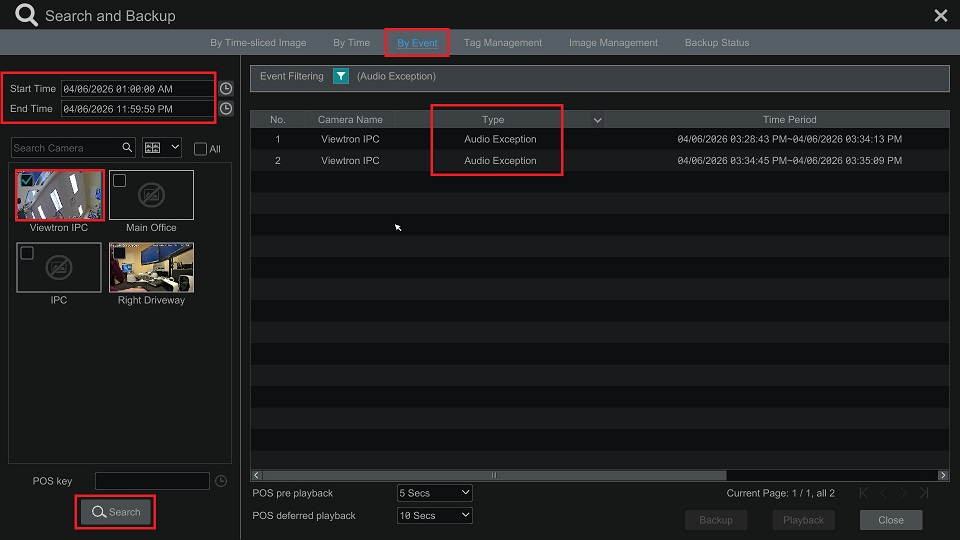

    4. Filter with Event Search
    Use Event Search and filter to Audio Exception so you only see those events for the cameras and time range you choose. Walkthrough: Viewtron event search.
    Viewtron Event Search filtered to Audio Exception results
