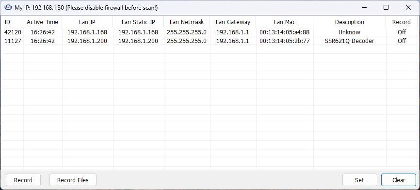

    Download the Viewtron Encoder / Decoder Network Scan Tool
    1. Download the Decoder Network Scan Tool on a Windows PC so that you can locate the decoder on your network.
    2. Unzip that file on your PC and run the network scan tool.
    3. The network scanner will search your network for all Viewtron Encoders and Decoders.
    IP Netwrok Scanner Tool
    You can see in the above screenshot, an IP encoder and IP decoder was found and the tool displays the LAN (local area network) IP address of it.

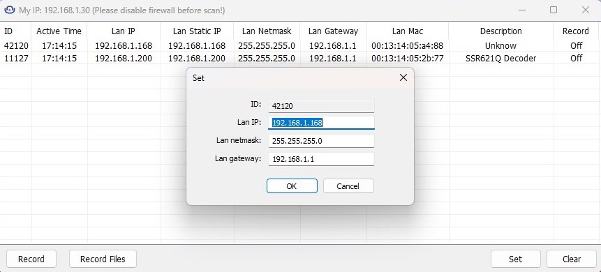

    encoder decoder set ip address
    If you need to set the IP addresses of the encoder and decoder to be within the range of your network, you can click on the device in the scan results, then click on the Set button in the lower right. This will bring up the IP address set window where you can modify the IP address, subnet mask, and gateway IP to match with your network.

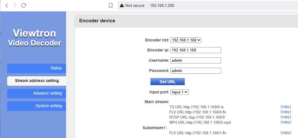

    3. Scroll down to the Encoder device section. The encoder list dropdown should display all of the Viewtron IP encoders on your network.
    4. Select one and enter the userid and password, then click Get URL.
    5. All of the encoders stream URLs will be displayed.

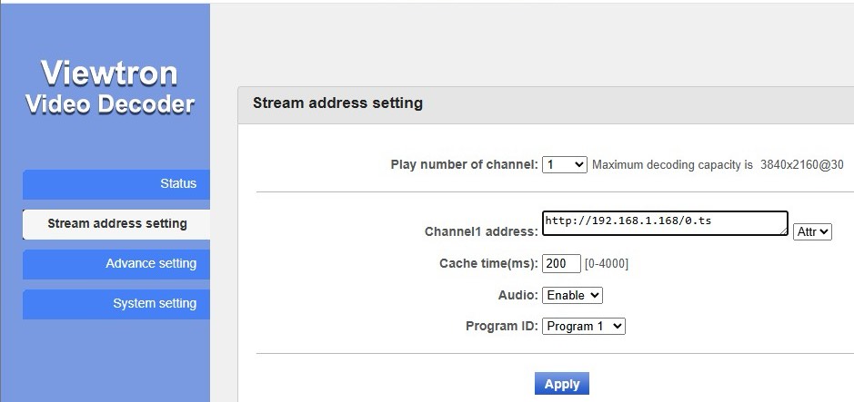

    6. Click on the (copy) link next to the TS url. Example from above: http://192.168.1.168/0.ts
    7. Scroll up to the top of the screen to the section.
    set encoder stream url
    Paste the URL into the Channel 1 address field and click apply.
    You should now see a live video display on your TV.

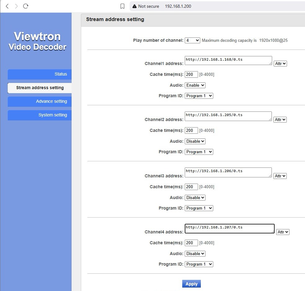

    Using Multiple IP Video Encoders with one Video Decoderone IP decoder with multiple video encoders
    The Viewtron IP to HDMI TV decoder does support more than one input stream. You can connect it to up to 4 HDMI encoders. To do this, change the Play number of channels from 1 to 2, 3, or 4 and press apply. That will open up the additional Channel address fields. Repeat the steps in the above section to select the video stream URL from the other encoders and paste them into channels 2, 3, and 4 and press apply.
    Your IP to TV decoder can now display the live streams from multiple HDMI to IP encoder boxes.
