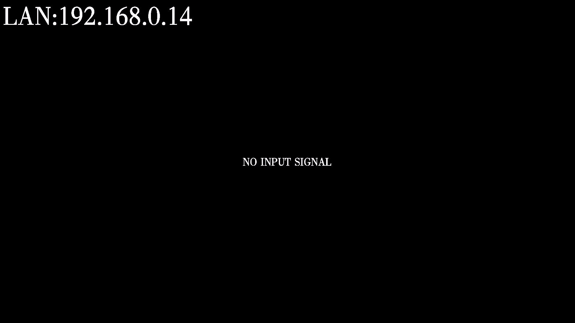

    IP to HDMI IP Address
    When the converter boots up and is not yet setup to connect to a video stream, it displays the IP address assigned to it on the screen. Use this IP address to access the converter via a web browser. The default user id is admin. The default password is also admin.

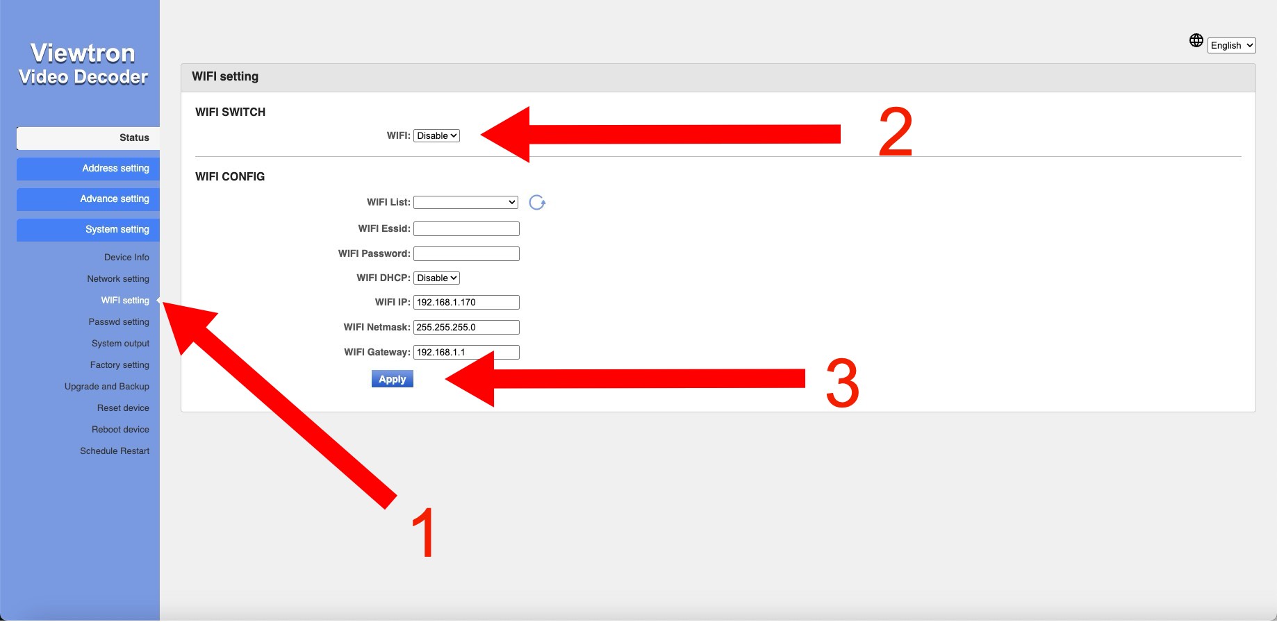

    After you login to the converter box, do the following.
    1. Click on the WIFI setting link under System settings.
    2. Change the WIFI dropdown to Enabled.
    3. Click on the Apply button.
    When done, reboot the converter box.

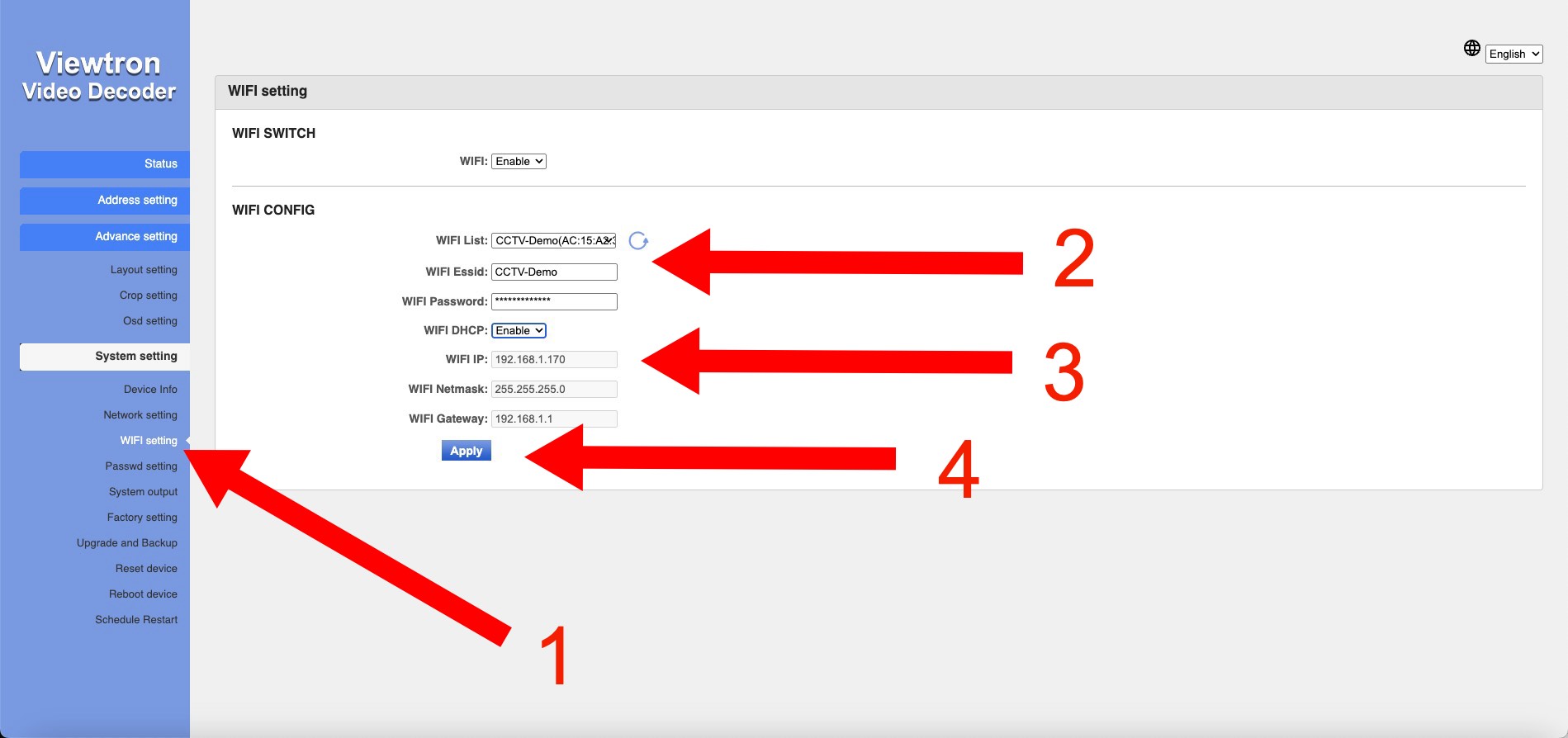

    After you reboot, log into the IP converter / decoder box again via a web browser and do the following.
    2. All of the wireless networks in range will now appear on the WIFI list drop down. Select your wireless network. Enter the WIFI password.
    3. You must either enable DHCP or disable and assign a static IP address to your decoder in the WIFI IP field. If disable DHCP and you are manually assigning a static IP address, you must also assign the WIFI Gateway and WIFI Netmask. This will depend on the setting on your router.
    4. Click Apply.

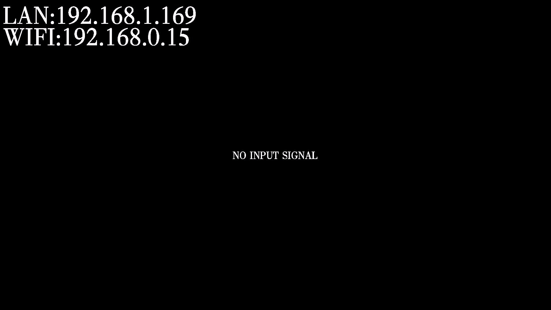

    You must reboot your decoder box again. This time be sure to unplug the network cable from the LAN port on your decoder, then unplug the power supply, wait 5 seconds and plug it back in. You must unplug the network cable before you reboot in order for the decoder to connect to your wireless access point.
    wireless connection IP address
    When you reboot, you will notice now that a WIFI IP address will appear on the screen. Now your IP to HDMI decoder is connected to your network over the wireless network connection.
