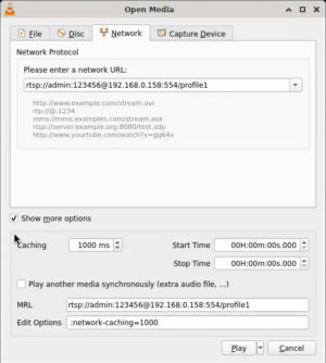

    Step 1 — Open a network stream in VLC
    1. Install and open VLC.
    2. From the menu: Media ? Open Network Stream… (Windows/Linux: Ctrl+N · Mac: Cmd+N).
    3. On the Network tab, paste the full RTSP URL into Please enter a network URL.
    4. Click Play.
    VLC media player Open Network Stream dialog showing RTSP URL for Viewtron IP camera
    If video appears, the RTSP URL is good. Use that exact same string in the decoder’s Stream address / Channel address field.
    Step 2 — If playback stutters (optional)
    1. Open Media ? Open Network Stream… again.
    2. Check Show more options.
    3. Increase Caching (for example 1000–3000 ms).
    4. Click Play again.
    VLC Open Network Stream with Show more options and network caching for RTSP IP camera stream
