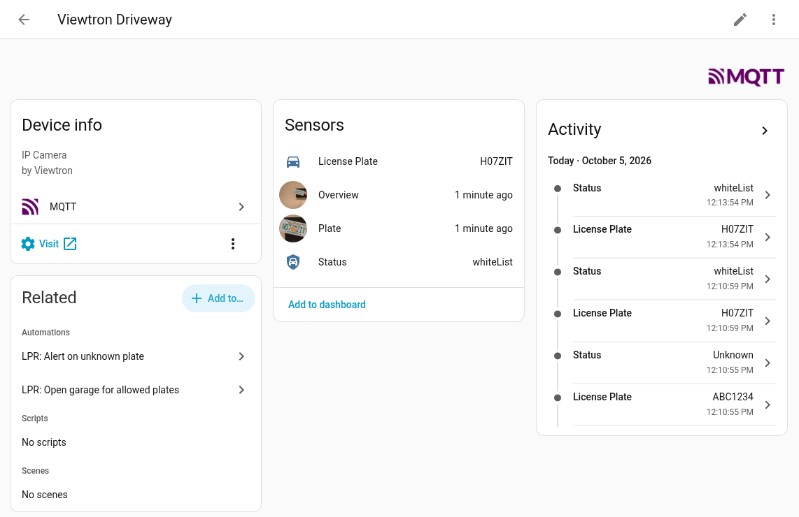

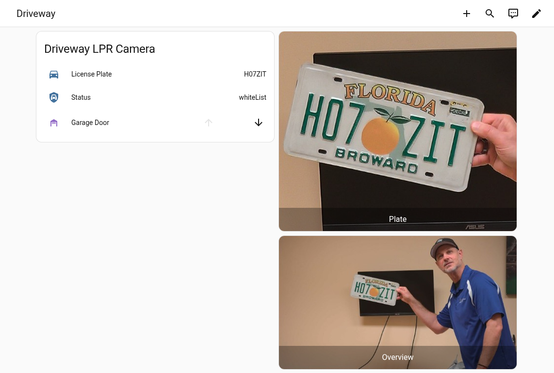

    4. Which Home Assistant entities does the LPR camera create?
    The first plate the camera sends creates a device in Home Assistant under Settings > Devices & services > MQTT, with four entities:
    • sensor.viewtron_<camera>_license_plate: the plate number that was read, for example H07ZIT
    • sensor.viewtron_<camera>_status: the plate’s list status, for example whiteList
    • image.viewtron_<camera>_plate: the cropped plate picture
    • image.viewtron_<camera>_overview: the full scene picture
    The <camera> part comes from the camera name the camera sends with its events. The bridge names the device “Viewtron” plus the camera name. My camera is named Driveway, so the device is Viewtron Driveway and the entities are sensor.viewtron_driveway_license_plate, sensor.viewtron_driveway_status, image.viewtron_driveway_plate and image.viewtron_driveway_overview. If the event has no camera name, the IP address is used instead (192.168.0.50 becomes sensor.viewtron_192_168_0_50_license_plate). Check the device page for the exact IDs on your system.
    Home Assistant MQTT device page for a Viewtron LPR camera showing the License Plate, Status, Overview and Plate entities
    The status sensor also carries the plate number, camera name and a timestamp as attributes, and the timestamp changes with every read. The automations below use that. Every new read also updates the plate and overview images, so a picture card on your dashboard always shows the last plate.

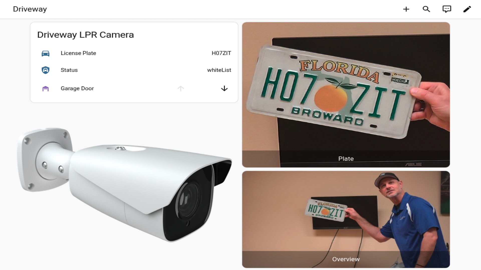

    Home Assistant dashboard with the Viewtron LPR camera plate number, whiteList status, garage door and the plate image entity

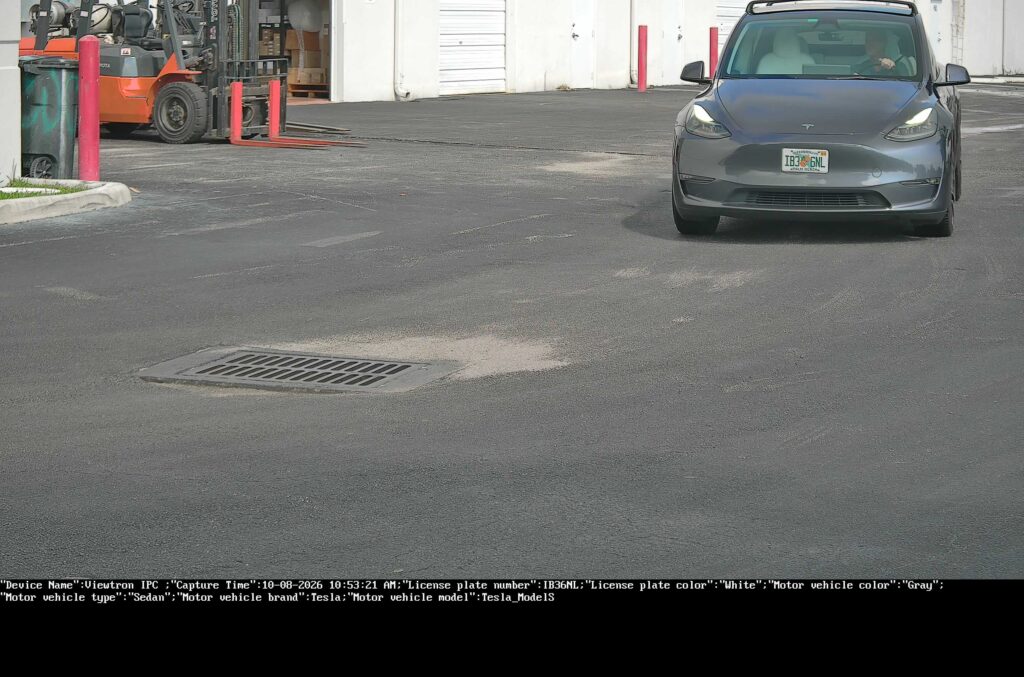

    Update, October 8, 2026: I tested this with a real drive-by past an LPR-IP4 running firmware 5.3.1. The test plate IB36NL was on the camera’s allow list. The camera read it at 99% confidence as the car came toward the camera.
    Viewtron LPR-IP4 overview image of a car with plate IB36NL driving toward the camera

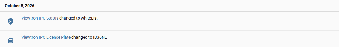

    Home Assistant changed the status sensor to whiteList and the license plate sensor to IB36NL:
    Home Assistant logbook showing Viewtron IPC Status changed to whiteList and Viewtron IPC License Plate changed to IB36NL

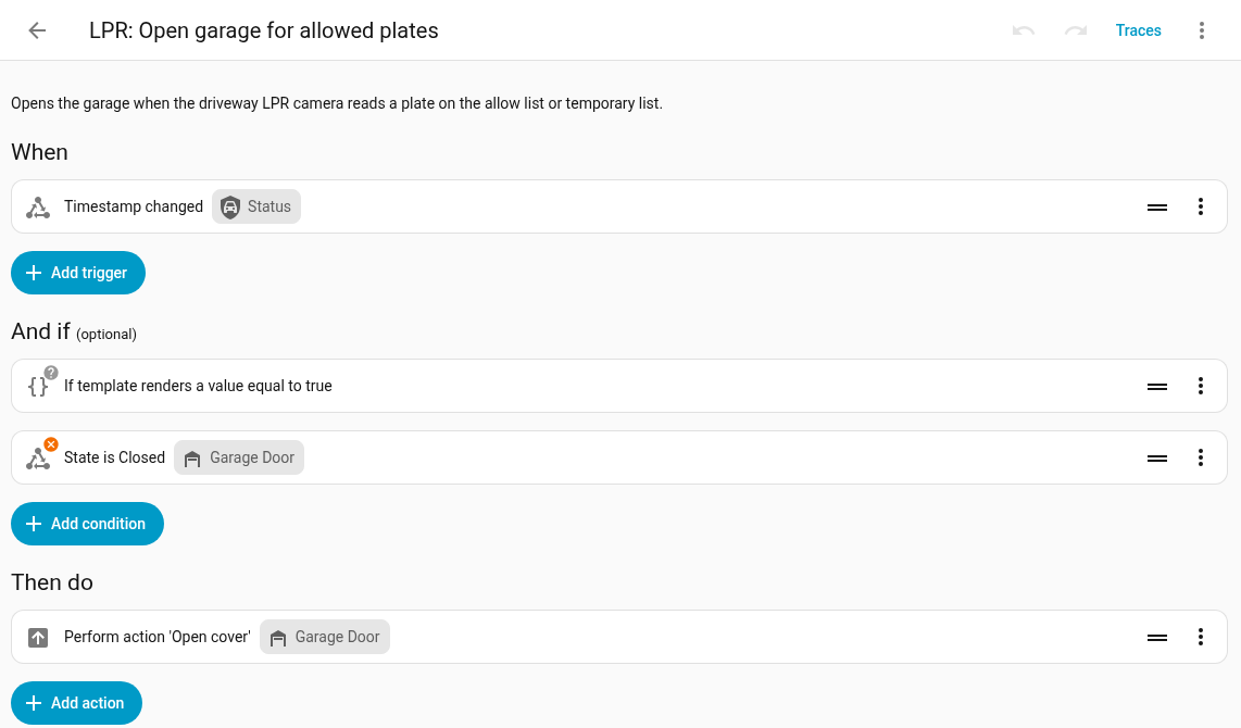

    6. How do I open the garage door when an allowed plate is read?
    Here is the automation I use. It opens the garage for allow list and temporary plates, and only if the door is closed. Add it to your automations.yaml file, then reload automations under Developer tools > YAML. Change driveway to your camera’s name and cover.garage_door to your own door or gate.
    - id: viewtron_lpr_open_garage
      alias: "LPR: Open garage for allowed plates"
      description: "Opens the garage when the driveway LPR camera reads a plate on the allow list or temporary list."
      triggers:
        - trigger: state
          entity_id: sensor.viewtron_driveway_status
          attribute: timestamp
      conditions:
        - condition: template
          value_template: >-
            {{ trigger.from_state is not none
               and trigger.from_state.state not in ['unknown', 'unavailable']
               and trigger.to_state.state in ['whiteList', 'temporaryList'] }}
        - condition: state
          entity_id: cover.garage_door
          state: "closed"
      actions:
        - action: cover.open_cover
          target:
      mode: single
    A few notes on why it is written this way:
    • It triggers on the timestamp attribute, not on the status. A plain to: "whiteList" trigger only fires when the status changes, so it would miss your second car pulling in right after the first one.
    • The from_state check means a Home Assistant restart, or the very first read that creates the entities, never opens the door.
    • If the reads come from an NVR, replace whiteList and temporaryList with your NVR group names.
    Home Assistant automation that opens the garage door when the Viewtron LPR camera reads an allow list plate

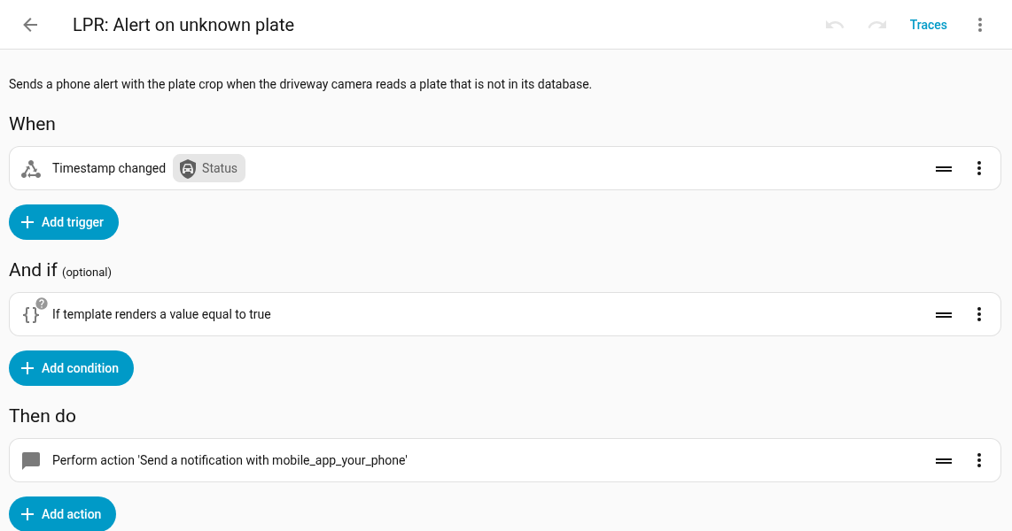

    7. How do I get a phone alert for an unknown plate?
    This one sends a notification to the Home Assistant mobile app with the plate number and the plate picture whenever the camera reads a plate that is not in its database. Replace mobile_app_your_phone with your phone’s notify action (you can find it under Developer tools > Actions by typing notify).
    - id: viewtron_lpr_unknown_alert
      alias: "LPR: Alert on unknown plate"
      description: "Sends a phone alert with the plate crop when the driveway camera reads a plate that is not in its database."
      triggers:
        - trigger: state
      conditions:
          value_template: >-
               and trigger.to_state.state == 'Unknown' }}
      actions:
        - action: notify.mobile_app_your_phone
          data:
            title: "Unknown vehicle in the driveway"
            message: "Plate {{ trigger.to_state.attributes.plate_number }} was just read by the driveway camera."
            data:
              image: /api/image_proxy/image.viewtron_driveway_plate
      mode: queued
    The plate number comes from the status sensor’s own attributes, so the message always matches the read that triggered it. Your phone has to be able to reach Home Assistant (on your WiFi or through your normal remote access) to load the picture. For a block list alert, copy this automation and change 'Unknown' to 'blackList'.
    Home Assistant automation that sends a phone notification when the Viewtron LPR camera reads an unknown license plate
